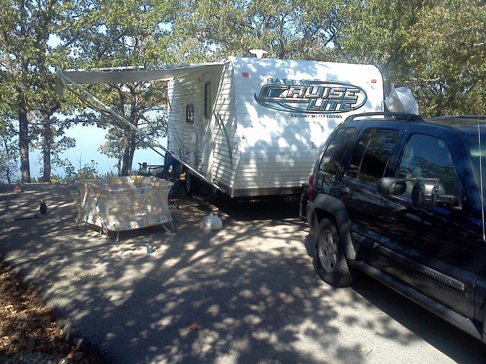

I haven't had much problems out of mine. I pull a travel trailer all over the place and just run it all day long. But mine is a 2006 things will break and wear out. But it paid for and it good on fuel . Most of the people have pretty good luck out of them. But i don't let it rev over about 3000 rpms. Don't think a diesel should rev much higher. Image
