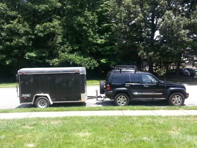

My CRD is being geared up for the 2nd trip from VA to Co. Its about 1800 miles and this round i am going the most flat route possible. I am going to be towing a Haulmark 5x10 enclosed trailer filled with household items. (Moving to serenity!). My CRD just turned 123k and runs like a top (well, the alternator pulley just began to squeak). I did just blow a CAC hose but I'm replacing both with Samco's. Like i said, Running like a top, lol. I have done the usual maintenance: Oil change, Driveline fluids and air filter. She has newer tires and Im going to do the trans fluid/filters and add the trans cooler before i go.
Anything else that i should check into. Funds do not allow for TCM reflash or id be all over it. I figure 60 mph and an easy foot, she should be good.
Oh, The CRD it self will have two skinny adults and 3 dogs (all 3 prob weigh 75lbs. total)
Thanks guys, hope to make this trip as easy as the last trip to Colorado, with great camping along the way! :JEEPIN:

If you can afford the time then slowdown to where you can run in fourth gear at a comfortable rpm level for the engine. The most fuel efficient rpm is around 2000 rpm (in terms of volume effficiency ). Lugging in fifth gear will build up heat. Do you have an EGT gauge?

Does your CRD has an automatic transmission with OD? My gasser does and I understand that it's best to leave the OD off to prevent it from possible over heating.
What exactly is the towing capacity of a CRD Liberty and do you know how heavy your loaded trailer will be?
I've learned the hard way that towing a 5,000 lb trailer with a gasser Liberty, with a towing capacity of 5,000 lbs) isn't easy.
Myself I used a Scangauge device plugged into the OBD2 port of my Jeep to monitor the engine water temperature. I don't trust the stock dashboard gauges.
I'm assuming you've examined your Liberty's rad hoses. Have you thought of flushing out the rad?
You're adding a transmission cooler, are you adding electric brakes too?

I have dragged a 5,000 lb, full height/width (ie, 8x8 feet) travel trailer from Virginia to the west coast twice, once via Denver on I-70. And I have a couple tips for ya.
(1) You need the Hayden Heavy Duty 2905 fan clutch. If you don't already have one installed, it's a fairly cheap and very worthwhile preventative measure.
(2) Overdrive off cuts out both 4th and 5th gears, so you are running in 3rd. This will help keep your RPMs up on any grades you do climb. And that will pull more cooling air through the radiator IF your fan clutch engages. Which the Hayden will. (All bets are off on the OEM clutch, especially if it is more than, oh, 30,000 miles old.)
(3) I found the frontal area of my trailer and the wind drag to be more the towing load than the weight. Dunno what sort of frontal area your rig has, but I doubt it is 8x8. Probably about 5x8. This will help. For what it is worth, I spent two separate days, one in Montana, the other in Oklahoma, towing into a 50 mph headwind. In both cases, 50-55 mph (ie, 100-110 mph windspeed) was about all she'd do. In the off chance you encounter such winds, I recommend laying low for a day or two and let the wind blow. I get 14-15 mpg normally while towing, but got 9 those two days.
(4) If you find yourself getting hot while climbing, do not fear going down to 3rd, or even 2nd gear. Increased RPM is your friend under such conditions. The worst thing you can do is try to pull too much grade in a high gear.
(5) I just dragged my 5,000 lb trailer up a 15% grade in 90 degree weather last week. To keep from overheating, I did have to pull over once and let 'er cool off. Beats hell out of blowing the head gasket and cracking the cylinder head. High revs are your friend in such cases.

1. CRITICAL if you timing belt has not already been done do NOT do the trip until it's done.
2. pretty much the same with a potentially bad alternator pulley. Dead battery will happen in the middle of no where.
3. pay close attention to turbo cool down procedures.
4. watch temp gauge. If it climbs take appropriate steps
5. when you install the Hayden fan clutch do yourself a future favor and mod the fan shroud for future access. See viewtopic.php?f=98&t=64278&p=709322#p709322
6. your trailer weight is such that it really should have brakes.

Seriously, this is what I guesstimate, anyone have anything I missed or think I'm too high / too low? We ALL know that the dealers will want to replace (or in their words, 'inspect for safety') just about everything, which means disassembling the entire engine, whether it needs it or not. Thoughts everyone?
Cards-on-the-table time:
Idparts shows the timing belt kit as IN-STOCK. $429 has everything you will need replaced.
Your local auto parts shack can get the Hayden heavy-duty clutch for about $60, and probably overnight. It is VERY common fitting part, fits just about every Jeep that I am aware of. I put mine in my 97 Grand Cherokee, fit perfect. The coolant is also readily available.
If you ordered the parts TOMORROW (monday) and wanted me to, I could be there on WEDNESDAY installing it. Yeah, that fast. You would be mobile again Wednesday evening. Can you really say that this is a bad deal? I'm not doing these jobs for the money. Yes, I do ask a reasonable amount for the job, but FAR LESS than a failure would cost you, and the cash does help me feed my other businesses (I work in film and television). My concern is about members helping members, and nobody should have to endure a timing belt failure EVER. Unplanned breakdowns SUCK.
