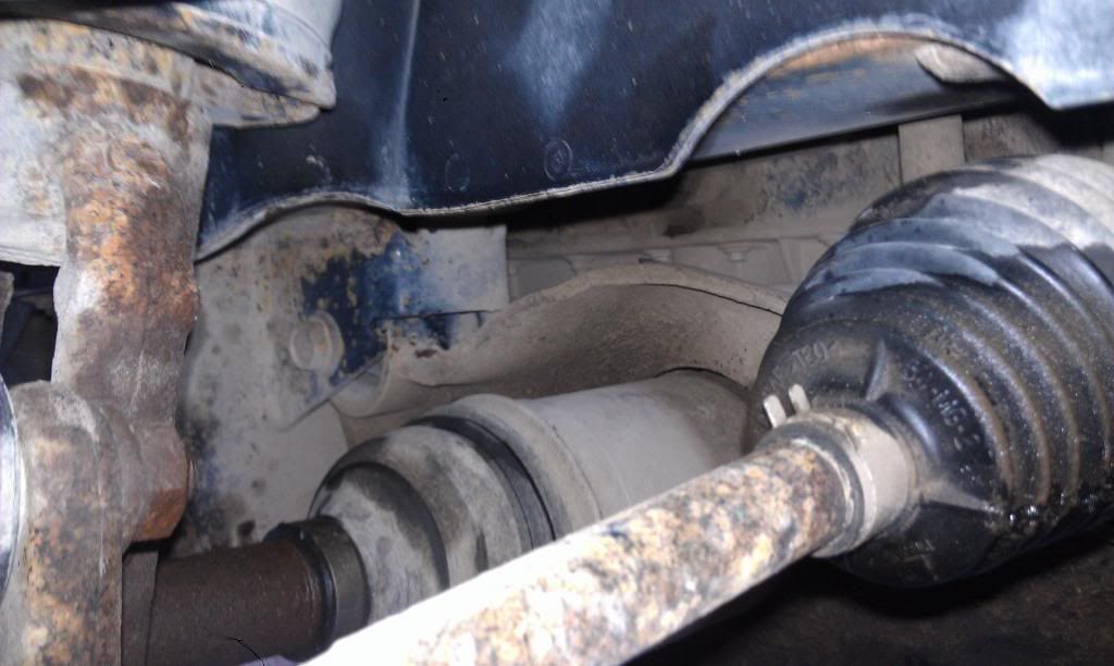

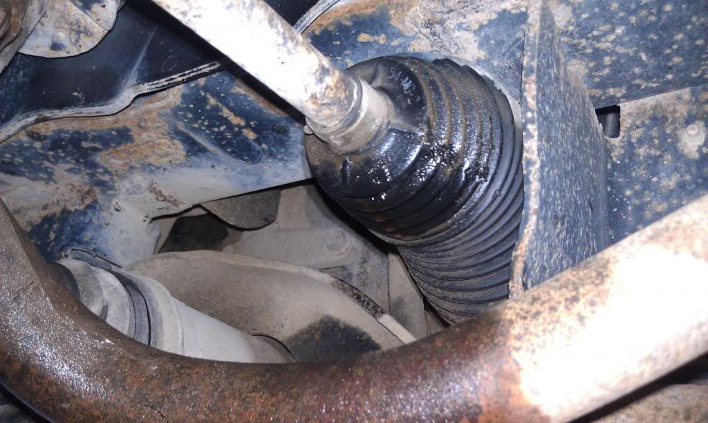

I have oil (It seems like engine oil, but I'm trying to figure out if it's power steering fluid) dripping down off of the passenger side boot of my power steering arm. I can't figure out where it is coming from!
I don't see a source from above!
I don't see anything coming off of the front axle shaft!
I don't see any holes in the boot or indications it's coming from inside
Can the piston leak power steering fluid into the boot? I've never seen anything like that. The other side isn't leaking, but I did have to refill the power steering fluid a few months ago.

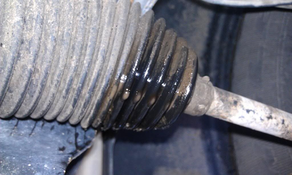

I checked the brake lines, and there are no signs of leakage. There are no signs of drips from high up on the fender either. This part of the plastic boot sticks out on the OUTSIDE of the plastic inner fender. Anything coming from the engine bay would drip farther up the plastic boot, and that isn't happening. I followed the hose coming off of the power steering bottle, and it looks dry all the way down. (I also noticed that my serpentine belt tentioner is jumping all over the place. Perhaps it's time to replace the original alternator after all.)
The fluid seems to originate on the bottom of the passenger side plastic boot for the steering piston. I am really thinking that I have a blown seal on the piston shaft and the boot is filling with fluid. In the dead of winter after cold starts in the work parking lot, I used to have no power steering until I got going. I wonder of this was a symptom of a problem.
As to the fluid's color. It certainly isn't a bright red like the ATF 4 fluid in the trans and the PS bottle, but it could just be dirty. I really can't tell. It doesn't smell like gear oil from the front diff, and if anything it smells a bit like motor oil. I was thinking turbo or boost hoses or airbox line to the turbo, but there is no sign of oil on anything BETWEEN the collected fluid on the boot and those possible sources.

Well I've cleaned the whole area of dirt and grease and it is now coming off of the boot pretty red. It matched the power steering fluid. I guess I need to look into a new rack and pinion.
Has anyone rebuilt their with seals, or is it better to replace the whole unit...
Does it even sound like the right track? I've never messed with Rack and Pinion before. Will the seals leak out of the piston? I guess I could try leak preventer first.

That looks like a power steering fluid leak out of your steering rack. Clean it off and if it looks cleaner red then its gotta be a steering rack.
You might think about replacing that sometime in the next 50k miles or so.

Yup, that looks like a classic power steering rack leak. This is the first one I have seen on a CRD/KJ. Has anyone else seen this on their KJ's yet? Just curious.

This stuff stopped my power steering fluid leak that derived from the same area.
http://www.lucasoil.com/products/displa ... 9&loc=show
 Post subject: Re: Can anyone explain this leak? Pictures included
PostPosted: Wed Oct 16, 2013 8:21 pm
Posts: 6302
Nothing at all wrong with dumping a full bottle of Lucas bear snot into the power steering reservoir - it might just plug the leak for you. The PS system doesn't hold that much juice, and if you aren't dumping quarts of juice into it, then it is a VERY small leak.

I put it in the other day and it seems to have worked. Thanks guys. Now for the motor mounts! I've been clunking for weeks.
