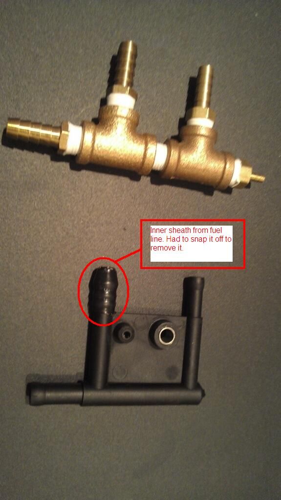

Odd that the codes come and go. P0299 can be related to a bad boost pressure solenoid (see viewtopic.php?f=5&t=70602&p=757348&hilit=boost+solenoid#p757348 for how to bypass) or a leaky vacuum line to that tower possible under the coolant tank but that's usually associated with power loss. You could bypass the solenoid and drive that way for a bit to see if the code stays gone. 0401 appears to be EGR related. You might try unplugging the MAF sensor (see picture on Sir Sam's NOOB guide) which will throw a code but disable the EGR. I don't know what code it throws but if it's not the 0401 doing this would be a way to see if 0401 stays gone.
I suspect you cleaned the MAP sensor (back of the engine) not the MAF sensor. If not clean the MAP sensor. Can you post a picture of your brass plumbing block fix? If you don't know how email me a copy and I'll post or PM/email me and I can tell you how to post.

1. papaindigo I did mean MAP, not MAF. I keep reversing them in my head for some reason. I cleaned the MAP sensor and broke the return block trying to move the hose slightly. I have a side by side photo of my homemade fuel return next to the brass one and will certainly post it below (if I can figure out how) or will send it to you. I got the idea from a LOST member post.

papaindigo, here's that photo of my brass return block
I did run into one issue with this...
The largest diameter fuel line had a plastic inner lining which was molded to the fuel return outlet/inlet. I couldn't pull it off, so I had to bend and break the lining. I clamped the remnant of the hose tightly around the brass outlet/inlet, but I'm going to replace that fuel line. In fact, I may just replace all of them.
