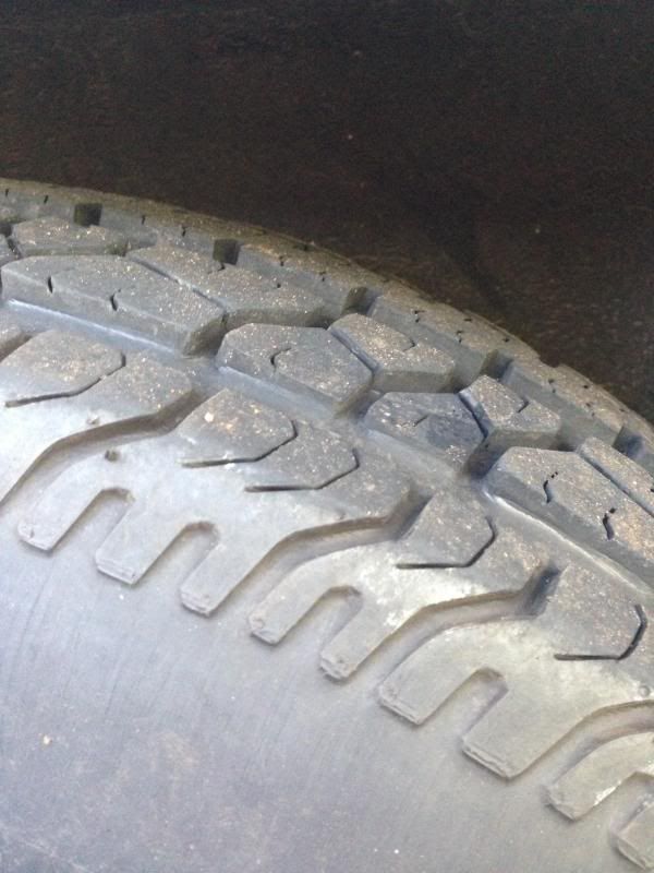

Hey guys...
I have been noticing this treadwear pattern on my trailer tires and was wondering what causes this type of a pattern. These photos are of the passenger side tire o the tire turns clockwise. The trailer is a 7 1/2x 12 concession trailer that weighs about 3800-3900 pounds emtpy and about 4800-5000 pounds when ready for use. The tires are 225/75/15 trailer tires with a load range D.
The pattern goes all the way around the outside edge of the tire in the same pattern where every 2nd and 3rd lug is wearing down like that. Any ideas?
Thanks, Jim

I could be wrong but it looks to me like you have 2 issues a) irregular wear which is like a tire balance problem unless your trailer has shocks of some sort in which case it could be shocks and b) a tire alignment problem which could be a bent axle or an axle mount problem. However, with respect to the latter I had severe edge wear on my original trailer tires for no "findable" reason and once I replaced the tires the problem disappeared.

It has a high speed wobble, which is both a balance and alignment issue.

Thanks for the replies guys. Being as these are trailer tires and not radials, would having them balanced help at all? The funny thing is that these are the same brand of tires (Carlisle Sport trailer tires) that I used to have on a smaller 5x8 utility pull cart type trailer and they did the same thing. The odd thing I find is that here is a pic of the other tire. This is the driver side tire that would rotate counter clockwise. You can see where it is just barely starting the same treadwear pattern as the other side even though both tires were installed at the same time just over 2 years ago. They have never been rotated to the other side.
Could worn bearings cause this? Also.....the trailer does not have any springs or shocks. It does have a torsion flex axle in it.

All I can say is that I have a 1 axle trailer and with wheels unbalanced, I shocked the back of the jeep very very lightly, at over 50. Once I balanced them, didn't even know I had a trailer..

Also, IMHO, Carlisle tires are junk. I have them on my boat trailer which has no issues, and they have funny tread wear too. I've also seen them with a uneven appearance of the sidewalls. I will not buy them again.
I have heard from a number of others that they are dissatisfied too.
I recommend finding a better radial tire for your trailer.

Worn Bearings, Lateral slop, etc.

For reference: This wear pattern is called "cupping" and can happen to your vehicle tires too.
Generally speaking, trailer tires are junk. That is why for all my trailers, I drive to the local used tire yards and find SUV radial tires for $30/pop mounted. They even balance them, which is great.
Torsion axles are a form of spring suspension, so you DO have a trailer suspension. What it doesn't have is shock absorbers.
I had a similar problem with the tires on the Ford Escape that my family just bought to replace one that got wrecked. The tires that came with it were way too aggressive and wrong for the vehicle, and the front had cupped BADLY as well. We suspected parts of the suspension, but after replacing all 4 with new Goodyear Assurance tires, the problem is gone and has not returned.
Sometimes it is a suspension component or a bad alignment (cupping can come from several sources) but in the case of your trailer... It is probably just that the tires are complete junk. Digging around to find some decent used tires with a high load rating (That is why I look for SUV tires) will be a rewarding way to spend an afternoon. Chances are, you won't ever wear out the tread on them anyway, and they are just trailer tires... So why not save some major money over $75 EACH for the same crappy tire?

This, on a car, can also happen due to improper tire rotation. I have that on the xj, the tires had not been properly rotated (my fault for being lazy) and I had them wear like a 'gear'. Try rotating the tires on the same wheel if it's bothersome, so the inside of the tire would be outside, but for a trailer it may not worth...
