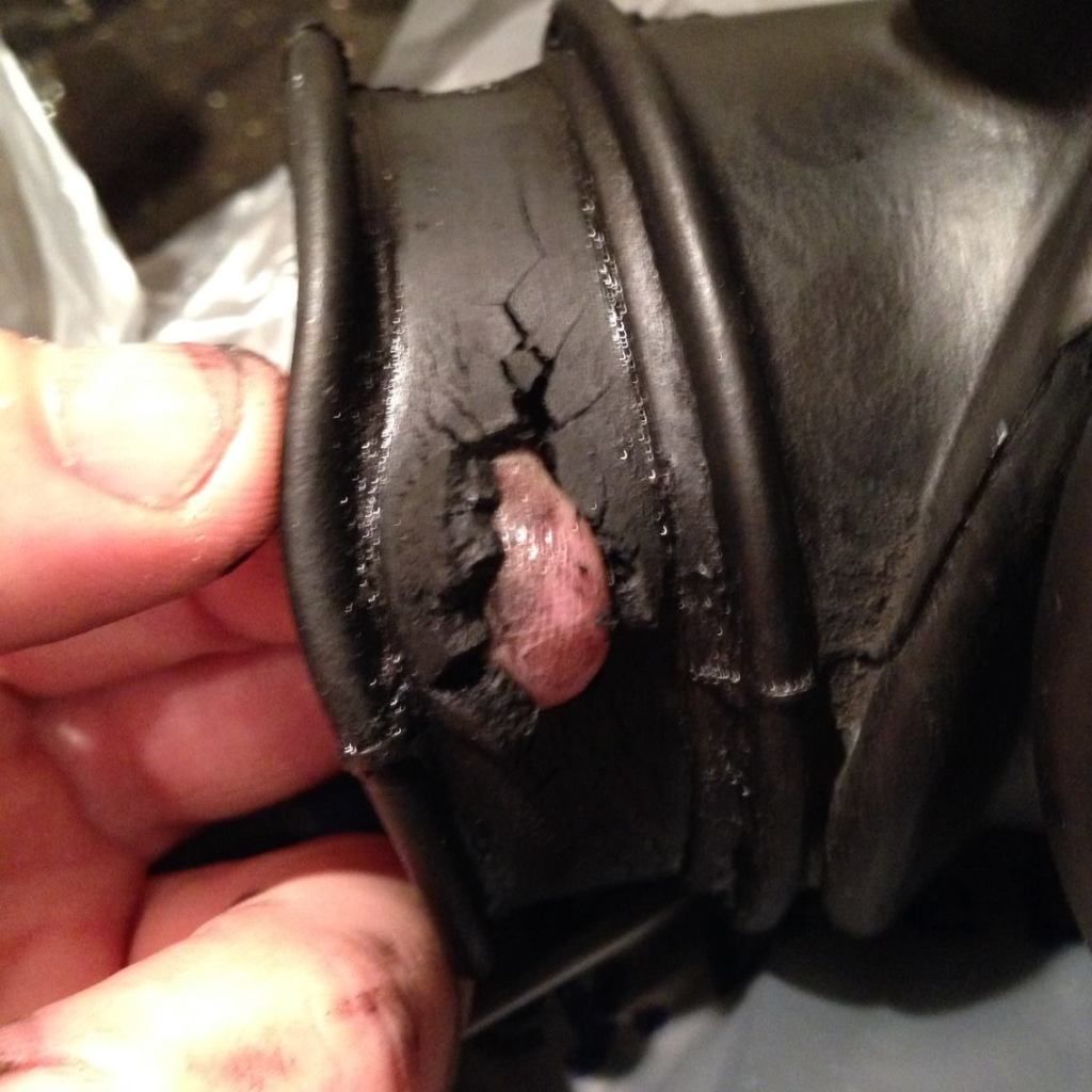

Well, you guys were all on the right track about the problem being something other than the turbo. The turbo is fine. In fact there's do discernible play in it that I can feel whatsoever. The turbo end of the airbox to turbo hose, however, had a loose clamp plus cracks and a hole. Look at this thing...
I'm still planning to degrease everything and check the other stuff you mentioned, but this makes me feel relieved.
I just can't figure out what my mechanic did to supposedly diagnose that the turbo needs to be replaced since it took me about ten minutes to find the obvious issue with the hose.

Everyone needs to check that hose if it has not been replaced on your Jeep. It appears to have close to a 100% failure rate.
He looked at the engine bay and identified one of two things as the issue:
1) The part that he least understands, therefore it MUST be the problem.
2) The part he can make the most on replacing, therefore the expensive part MUST be the problem

Air filter to turbo hose PN 53013104AE runs on the order of $65 at a dealer. Mail order cheaper but shipping can eat up the savings although I note a good price with shipping on Amazon and that ID Parts also has them possibly with a good shipping deal.
Failure rate is somewhat random and I would speculate somewhat dependent on the individual hose quality; type of oil used; and the amount of oil coming from the CCV into the hose just in front of the turbo. My son's (stoutdog) 06 hose was gone at about 30K miles but mine is still fine at about 50K miles. I'd make it an item to check while changing oil.

I noticed a similar crack on my air hose last time I was in there (for the timing belt change) and sure enough, a few weeks later a telltale stream of oil coming down the bottom of the turbo casing and the drain tube appeared. A couple questions:

I just pulled my spare off the shelf. It's complete from air box end to turbo end including both clamps but excluding the CCV line although of course it has the place where the CCV line plugs in. From past install experience:
1. best done with the hose warm not cold as it gets stiff, I keep an old hair dryer in the garage for that sort of thing;
2. the turbo end should go almost all the way up to the turbo end of the flange although a gap of like 3/8" is ok.
3. the air box end MUST touch or almost touch the MAF sensor. Failure to get it all the way on WILL result in a crushed air box outlet flange, been there done that. Run the air box hose clamp down snug not godzilla, same as you should do on the plastic flange ends of the CAC hoses, and recheck tightness after a few days of driving.
Obviously check the turbo shaft for play while you are in there.
