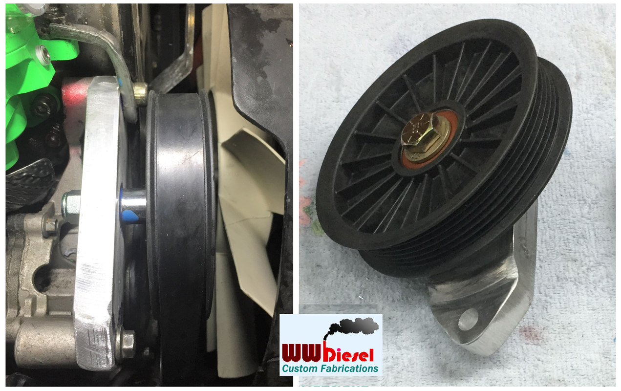

I build a custom kit to completely remove the viscous heater and it's plumbing and replace it with a Gates pully.
Pulley & mounting bracket are a direct bolt in replacement for the OEM viscous heater reusing OEM bolts, no other mods required other than rerouting one hose from VH to thermostat housing.
This allows you to reuse your stock OEM belt. Comes complete with install instructions & procedure.
PM or email me if you are interested, I currently have one left in stock. Free shipping in US.
