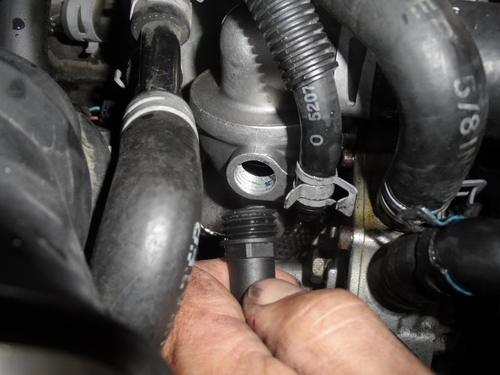

Hello all,
As you have probably guessed, I just replaced my thermostat. I ordered it from ID Parts on Thursday and it arrived yesterday. Last night I installed it and this morning flushed and refilled the system. After refilling with 2 gallons of Zerex/ 1 gallon of distilled and "burping" the system, I took it for a test drive. :D MUCH to my dismay, the hose barb in the below photo started to leak profusely. :banghead: I lost a bunch of my anti freeze, to the tune of $18 ish a gallon. :furious: As the photo shows, this "oem" replacement had no sealant on the threads.
Upon taking the hoses back off, I found it to also be only finger tight. :roll: This does not impress me at all. The ones from Jeep never had this issue. Just for kicks, I tried to get the old one apart and couldn't turn it with a wrench without stripping it.
I am up and running because I was able to seal the threads with RTV, however, I will have to drain and refill the system again as I am on running distilled water for now to be sure nothing else leaks, :juggle: before chancing more wasted antifreeze.
There is good news too. The temp guage now is showing the new thermostat is holding the correct temp.
I will be calling ID parts in the morning. Hopefully, they will work with me.

MRausch82 wrote:
That stinks! Crown has been known for inferior quality. I do not use, sell, or recommend Crown to anyone... that is just my :2cents: though. Sorry this happened!
Well, I'm not pleased about this. If that needs to be sealed, fine, then some directions to do so are in order!

Tree Catcher wrote:
the mating surface is not flat where it bolts to the engine. i would have to machine this flat and try to clean out the casting flash . Now not so happy..
Sean
Mating surface looked ok. No debris inside that I noticed.

 Post subject: Re: Crown Thermostat Advisory!
PostPosted: Mon Aug 19, 2013 6:50 am
Posts: 1111
The OEM t-stat had some liquid plumber seal on the nipple threads that drys and hardens. The Crown does not apparently. Install the sealant, install nipple and let sit overnight.

MRausch82 wrote:
I'd return it and just get a Mopar unit. Problem solved.
Too late. I was not going to reinstall the old one. I have sealed the crown unit, and as of now, no leaks.

Oh yeah, I almost forgot to mention this. I called Corey @ ID Parts and he is going to contact crown and see where this goes. :juggle:
I have also noticed he has posted that he is now warning people to check for this issue. I am sure many will appreciate the heads up from the retailer. :wink:

Update:
Corey @ I. D. Parts and I spoke today. He informed me that Crown will be issuing a warranty refund. :pepper:
I want to thank Corey for standing behind the products he sells and pursuing a resolution.
