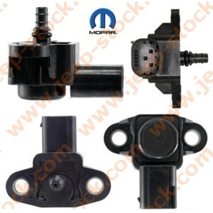

Hello, I keep getting a P0110 code on my 05 CRD which then shows both P0110 & P0105 codes. I can delete them but they both come back almost immediately. I changed the Map sensor which helped for a day. Then the issue came back. I have rebuilt top end 1.5 years ago by JoshCRD, EGR delete & GDE tune.
What controls the P0110 code. This is for intake temperature circuit which I can't find separate sensor for. Everything I read says it is controlled by map sensor. Once P0110 fault is set then P0105 follows quickly. Is it wiring, sensor or ECM?

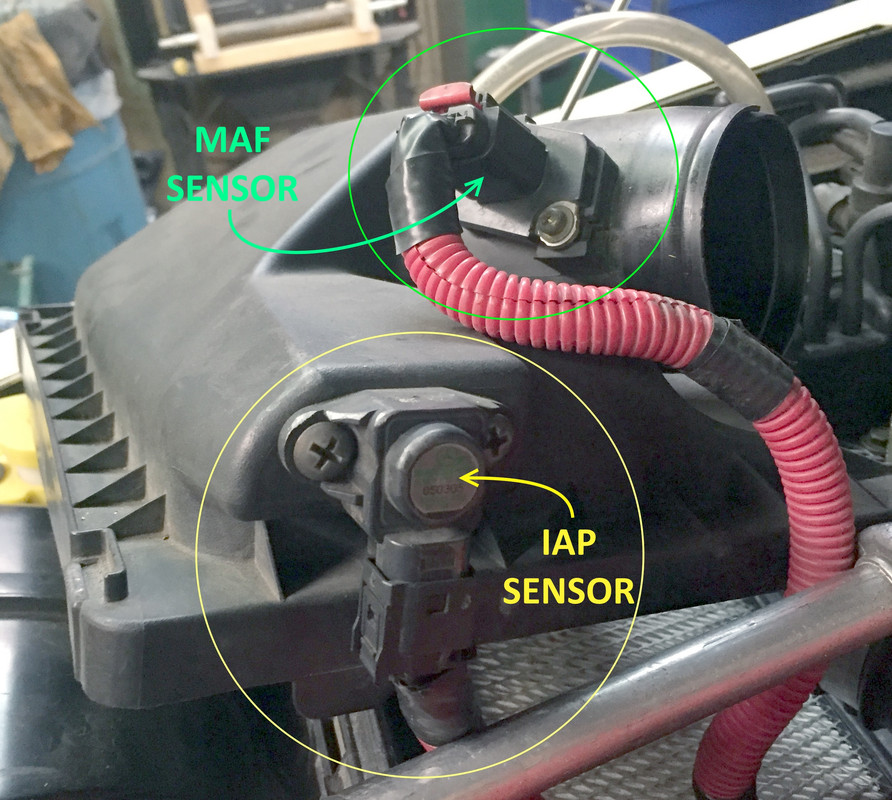

P0105 -- Manifold absolute pressure (MAP) sensor/barometric pressure (BARO) sensor – circuit malfunction Wiring, MAP sensor, BARO sensor, ECM
The MAP sensor is a combined intake air temperature sensor and an intake air pressure sensor
P0110 -- Intake air temperature (IAT) sensor – circuit malfunction Wiring, IAT sensor, ECM
The IAT is the turbo inlet (air box) pressure sensor.
IAP sensor – OEM part no.: 05101120AB (intake air pressure sensor on side of airbox)
air inlet air pressure comparator pressure sensor on the side of the air box;
sometimes referred to as the “Mercedes sensor”
Check your wiring and sensor connections and make sure you don't have a loose (bad) connection or a chaffed wire somewhere.
IAP SENSOR

joelukex4 wrote:
First you said that the MAP sensor is the IAT & IAP combined. Then you say the MAF ( turbo inlet sensor) is the IAT. Which is it. I believe it is MAP sensor. MAF sensor is only air flow.
What I said was correct, read my post again and study the picture!
The MAP sensor senses the intake manifold boost pressure and air temperature inside the intake manifold.
The IAT sensor senses the air pressure inside the air filter box on the inlet to the turbo.
They are totally separate and different sensors with different functions!
Never said anything about the MAF sensor, it has nothing to do with the DTC's (P codes) you said are getting. It only senses air flow for EGR system operation.

there is some confusion
the Intake Air Temperature sensor is a part of the MAP , Manifold Absolute Pressure
P0110 is IAT failure and P0105 MAP sensor circuit open or shorted to ground ,if you have changed the MAP sensor check the entire wiring from sensor to ECU
the other map sensor on the side of the air box cover is needed for read the atmospheric pressure and help the ecu to calculate the engine load

Hi mate thanks for that, I suspected the map sensor on the airbox was probably to measure the atmospheric pressure.
So is it just plumbed into the airbox in order to ensure that it stays clean? And if so, does this mean it would function just as intended regarding calculating engine load even if it is removed from the airbox and just sitting loose in the engine bay for example? (Obviously disregarding the cleanliness factor)
Cheers mate
 Post subject: Re: P0110 & P0105 Codes
PostPosted: Wed Oct 26, 2022 10:39 am
Joined: Sat Jul 11, 2009 4:17 pm
Posts: 872
Location: Biella Italia
it read the vacuum for calculate the load than must be installed after the air filter
