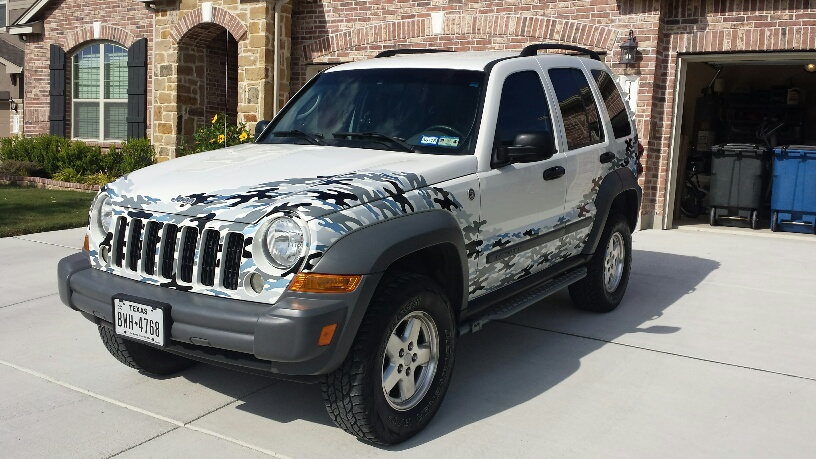

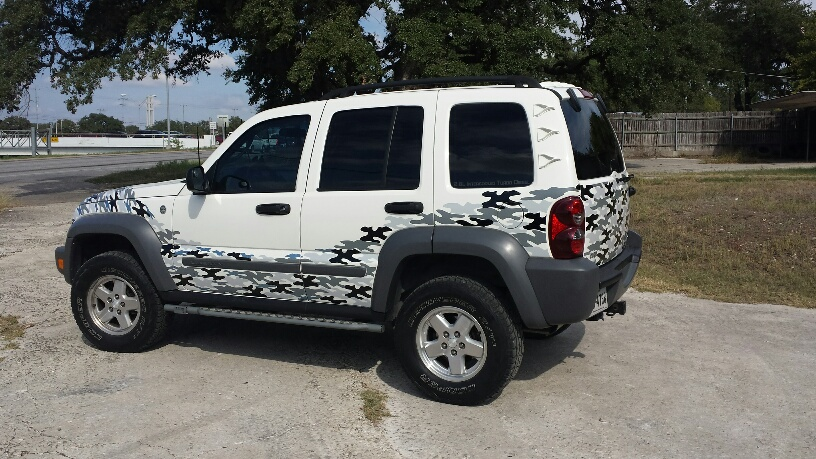

[img][img][img][img][img][url][/url][/img][/img][/img][/img][/img]170K
Glow Plug broke and went thru engine at 8200 miles...Jeep replaced whole engine including turbo.
GDE Hot Tune at around 60,000 plus I did the original LOST EGR Bypass (developed by LOST Member) a bit before the GDE
Have replaced:
1 CV Axle Front
Front Driveshaft
U-Joint
Rear Pivot Arm Bushings
OME Lift
1 glow plug
Ball Joints twice
timing belt at 125,000
Still on Stock TC with GDE Hot Tune...fingers crossed
Next to Do's:
TC Replaced and GDE Turbo Upgrade (maybe freshen up top end)
Otherwise, has been very good to me...added a vinyl job to make it "new to me"
Also added some decals to wheels for some extra umph:
Founder of L.O.S.T.
