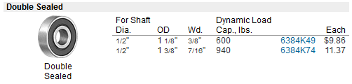

The amount of surface area inside of the bearing, the number of balls, and the size of the balls would make a difference.
This is from McMaster-Carr, the outer size of the bearing makes a difference in the load rating, but I am unsure how it will effect lighter loads for longer periods.
Phil
Thanks for sharing, I'm not concerned regarding the load to be honest, can't be a lot of load from the timing belt, I'm more concerned with the reliability on long term, as you said. I'm very tempted to try it, even though I have new OEM on the shelf.
