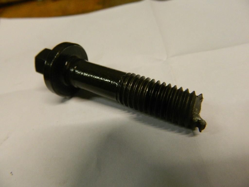

Hi,
I had the exact same thing happen, just as you described. I estimate 130ft/lb snapped it.
 Post subject: Re: Head Bolts Torque
PostPosted: Tue Apr 29, 2014 6:29 pm
Posts: 6302
Ok, that is NOT where it is supposed to "tty" if it does at all. That looks to me like a massive change in the metallurgy that they are getting the bolts made from.
OR if there wasn't a change, then perhaps the supplier never properly set up the stock in the first place. I was unable to get one of those bolts to snap at 250 lb-ft of torque, and I was working with a nut at only the bottom 6 threads or so - so if there was a weak spot in the middle, it would have shown itself.
Something has definitely changed. I'm assuming those were new bolts?
Sorry I should have given more info. I bought a 'fixer upper' 2.5 CRD so when I replaced the head I tried to re use the original bolts as this has been discussed a bit onthe forum it seemed like a good idea! The Jeep was a 2004 year with 142,000m. As with the OP the other bolts seemed to torque OK but this one just turned and turned and then 'snap'. I was experimenting with just using a torque setting rather than the 'angle' method.
When I changed the head on my 2002 2.5 CRD the bolts were different. The unthreaded portion was much longer and also thinner than the threaded portion. I bought new bolts for that vehicle and I'm pretty sure they were threaded all the way to the head. (The new bolts weren't genuine though...)
