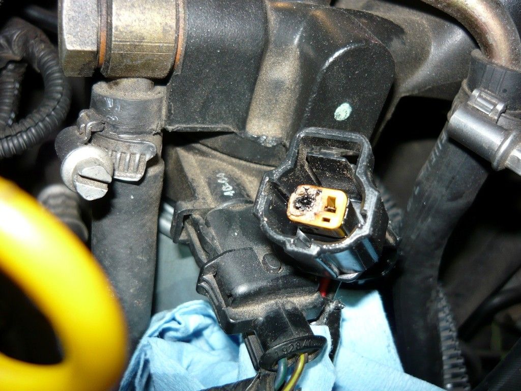

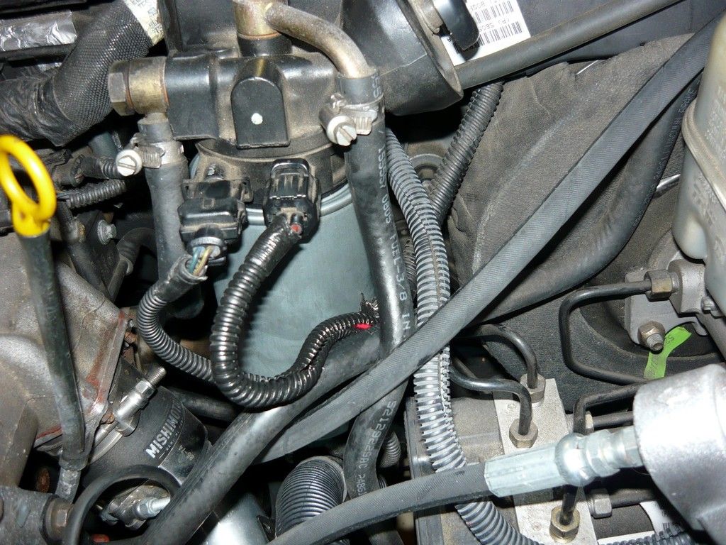

Could this be it?? I saw fuel on the fuel heater wires (see pic) and then pulled the fuel heater plug (on fuel head) and it is burned (see pic). I assume this is sucking air into the system.
Thoughts?

Looks like you have gen 1 fuel head. Burned gen 1 fuel heads are known for ingesting air. I would upgrade with gen 2 fuel head to rule out this possibility and to have peace of mind in future.

IF you are going to replace the fuel head then temporary solution would be to epoxy/jb weld the heater connector on the fuel head. You may get CEL if you don't have heater connector attached.
Yep...gen 1. I will order a new one now. Read that many use Racor but I will research.
Great idea to epoxy with JBweld. Let's see!

Thanks much! It was the heating element in the OEM original fuel head. I took your advice filled the jack with 2-part JBWeld epoxy. I then bled the air out by priming and bleeding and it started right up. I have a CEL but that is to be expected. I have ordered a updated OEM fuel head and will take the advice and buy/install a lift pump.
