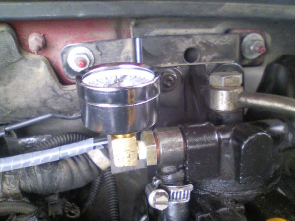

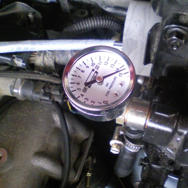

I installed a gauge on the fuel inlet to the filter, by drilling and tapping a banjo bolt (M14) and adding a gauge.
When the Jeep is on and idling, the gauge is at 14.5 PSI.
This leaves me with a few questions.
Is this too much pressure? Will my CP3 pump eat its seals at this pressure?
Who else has this lift pump installed with no long term issues?
Does anyone else have a gauge on their fuel system?
How much pressure is lost across the filter?
Phil
 Post subject: Re: Installed Lift Pump, then Limp Mode and Check Engine Cod
PostPosted: Tue Apr 29, 2014 9:54 pm
Posts: 5171
Mine puts out about 10psi on the output side of a Racor - no problems for ~ 80K miles

Location: Dubuque, IA
While doing a lot of searching about how much pressure is too much, I found that there are several users using this lift pump and none have had issues with it.
However, I could not find any difinitive info on what the max pressure should be. Between searching on here and on some Dodge Trucks forums I am guessing you dont want your lift pump to be over 18-20 PSI.
Phil
PostPosted: Wed Apr 30, 2014 8:56 am
Joined: Fri Apr 24, 2009 5:55 pm
Posts: 414
Location: CANADA
I have the in-tank pump running the same pressure. Its been in since 2006, no problems. If you add another gauge to the clean side its a great way to tell when the filter is getting restricted by the pressure differential.
