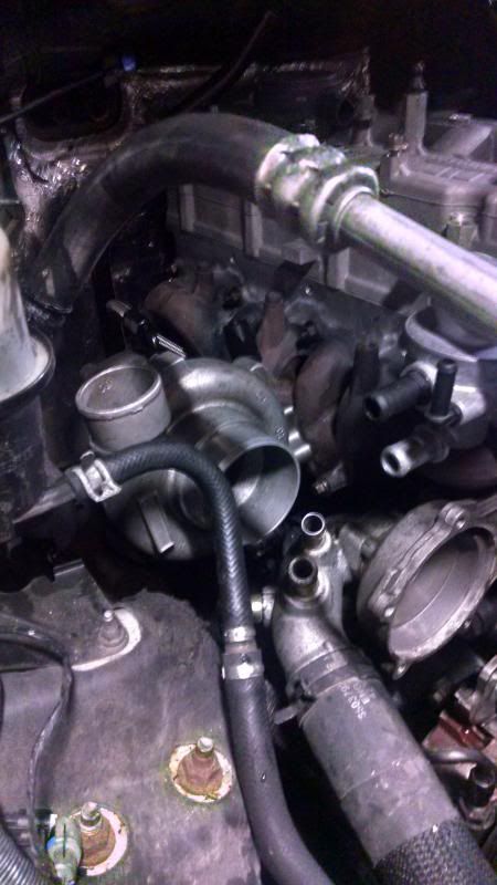

Im in the middle of putting my jeep back together. I've already deleted the egr, fcv, and the cumbersome factory vnt turbo. I'm taking this thing back to a plain diesel engine with a Garrett ball bearing turbo. Getting ready to run the coolant lines to the turbo and noticed the tight-necked water pump inlet is right in the way of making a nice air inlet for the turbo. If I can get rid of the viscous heater, and make a new water pump inlet I'll have it made.

Here's a couple pics of what things look like now Image
I think I can make a new, more rounded inlet elbow for the water pump. Relocate some nipples and I think it would look beautiful. I hated opening the hood and not being able to see the engine.

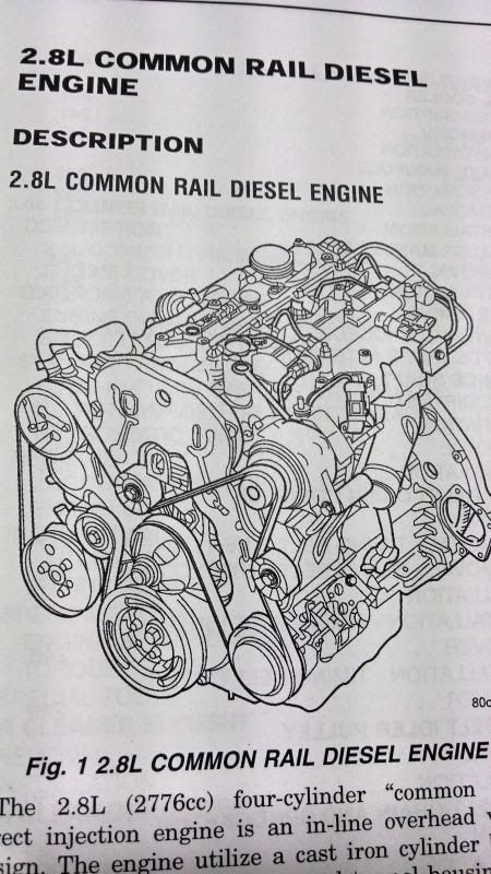

Found the diagram in my service manual. Starting at the crank going left it goes over the tensioner, around the power steering pump, under an idler and then up to the viscous heater, to the fan and over to the alternator. You could get rid of the VH but the belt will have to the go over the idler pulley instead of under it. Which means I need to find a ribbed idler instead of the factory smooth one. I took a pic of it but must of deleted it arch. Gonna try to start on the new water pump inlet tomorrow if I don't work.
