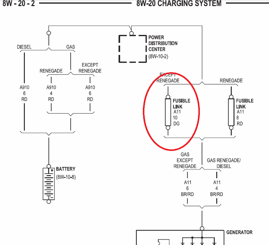

Okay, so it will run if I use a jumper wire on 30 and 87 and I get no voltage at fuse #28. If I read your post correctly, it sounds like a bad ignition or actuator pin.
I need to go to the local tool store for the correct torx bit...thank you for all the help!!
Amended-I have been bothered by the under volt, so when I got the jeep running, I put a meter on the battery and it read 11.3 volts!! I then hooked up my battery charger which also tests the altinator and it confirm the low voltage by say "bad alternator"
So, the altinator will be replaced as well, but don't understand the no starting....another item I noticed when running is the AC fan was running although the AC was not on. Is this because the relay was removed?

Be sure and also check the fusible link no. A11. If this link is blown then the alternator cannot supply any voltage back to the battery!
It is a link between the alternator and the power distribution center.
Check the voltage on the back of the alternator with the engine off. It should read the same as the votage at the battery. If it does not then the link is blown!

Thank you! I have confirmed that I do have power to the alternator so the link is not blown.
This is a relatively new alternator with a lifetime warranty, so I will pull it and get it replaced.
