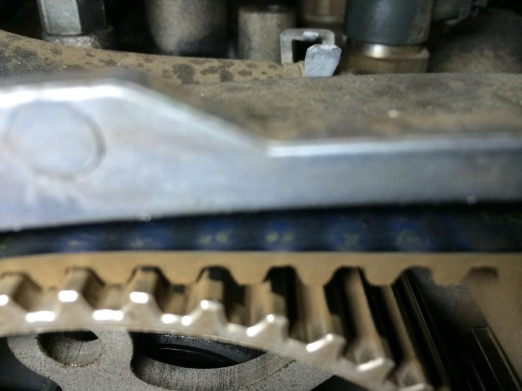

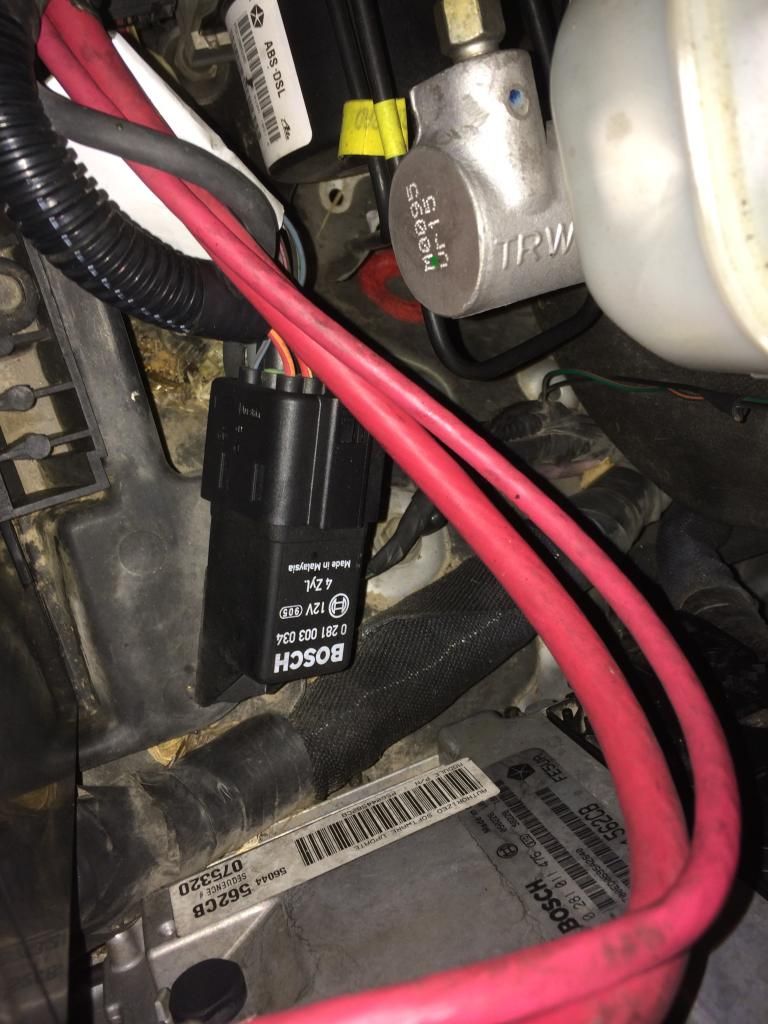

I got some quality time under the hood today. My goal was to inspect the #1 Glow Plug and determine if the original ceramic 7v GPs had been replaced with 5v GPs. I was able to pull #1 with very little trouble. It has a white band and printing on the side. Its marked Bosch 7v. So there's the answer to that question.
QUESTION #1 Now should I replace them with the 5v? My relay is the part number corresponding to the 5v swap.

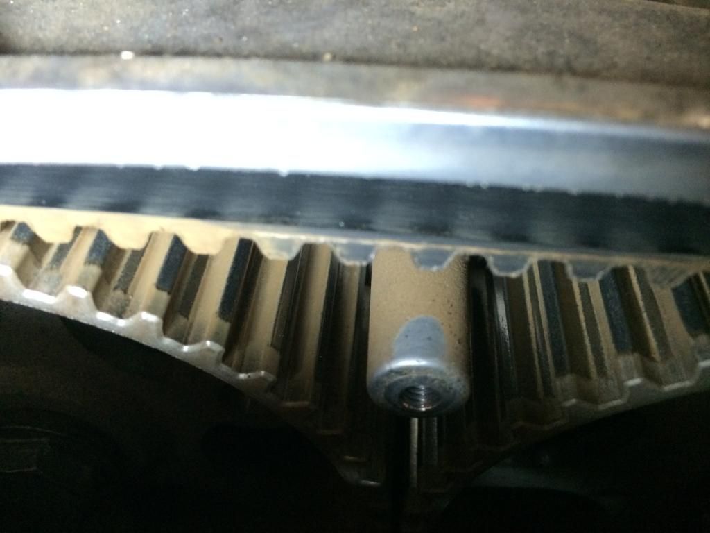

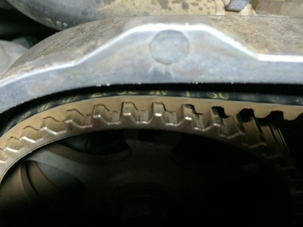

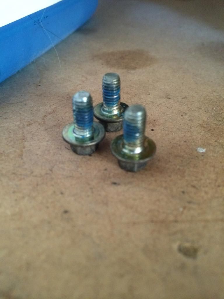

The next goal was to pull the timing belt cover at the top and get a look at the TB. To my surprise, the TB cover bolts had fresh looking blue loctite on them.
I got the top part of the cover back far enough to inspect the belt. I marked it and bumped the starter so I could inspect every inch at least from the side. Belt appears to be fairly new. It's a Goodyear.
QUESTION #2Combined with new blue loctite, what would you guys conclude?

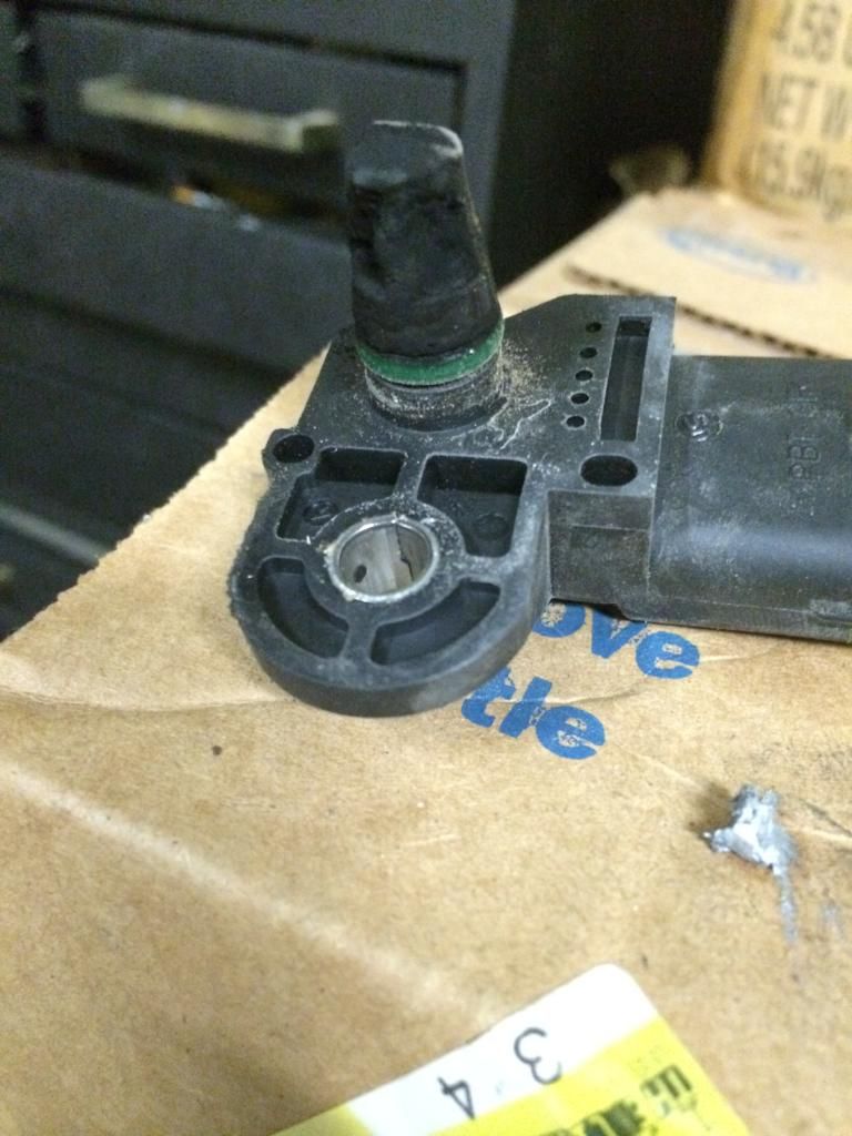

Third task of the day was to pull the MAP sensor. Very easy task and BOY was it dirty. Completely clogged with soot. I bought some MAF cleaner and got my compressor tank full of air. I cleaned every visible spec of carbon off that guy and blew it out multiple times with air. Reinstalled and started up. She purrs like a kitten.

The belt looks to me like an old one. The replacements I have seen are all Gates brand, Goodyear seems to only be the dealer replacements, and that would have been logged in the service records even if it wasn't a warranty job. They are supposed to log everything they do to a vehicle.
I didn't see any obvious cracking, but that doesn't mean it isn't there. For the peace of mind, I'd still be thinking about a belt job.
Plus there's air chisel marks on the fan clutch nut. I've seen the techs at Firestone and Goodyear using that method. I'll order the timing belt kit and get it done to be completely thorough.
You may want to order a new MAP sensor and save the old one as a spare? We discovered the following part numbers are all interchangeable with the GM one being the least expensive. It is best to always have a spare!
Bosch 0281002437 or 0281002845 Intake Manifold Pressure Sensor
GM Part No. 55206797
http://www.gmpartsgiant.com/ has them for $18+ some change.
Unplug your MAF sensor located on the intake boot until you can get a tune, this will disable the EGR valve and stop the constant flow of poop into the intake manifold which is what is fouling the MAP and everything else in the top of the motor. Running with the MAF unplugged will not cause any problems other than tripping a CEL.
Get a tune ASAP, your engine will love you for it!!!!! :BANANA:

About the MAP sensor: Nothing wrong at all with the GMpartsGiant link, but for $3-$7 more... I'd give my money to IDparts and support the vendor that has been relentless on sourcing the best parts for these orphan vehicles. As an added bonus, if you are already buying the timing belt kit (and the Graf water pump is BETTER than the OEM!) then there shouldn't be any added shipping for such a small add-on as that sensor - they will just drop it in the box.
