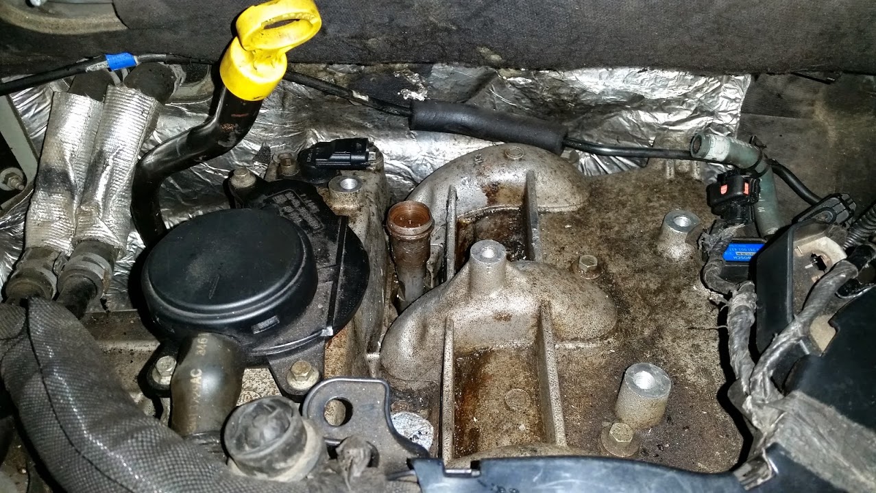

I have tried everything I can think of to get the injector out, I have had it soaked in PB Blaster over night, tried coke too. I built a couple versions of pullers. One with bolts on each side with a notch between to grab the injector. One with a pry bar over the injector, I start lifting the weight off the suspension with this and it still won't budge. I can get it to twist about a 1/4 to 1/2 turn back and forth, but it won't come up any. I can't try running it a little because I have the timing belt off.
I am going to try to build some kind of slide hammer contraption next. If anyone has any ideas please let me know.

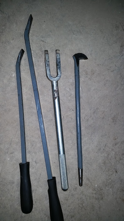

Using one of these as a lever:
http://www.harborfreight.com/16-inch-ti ... -1759.html
Wiggle the injector back and forth (not spinning) while using the tie rod tool as a lever to force the injector up. If you play around a bit with the tie rod tool, you'll find a place to grab the injector with the fork, and a sweet spot on the manifold to use as a fulcrum. Wiggling has helped several people get the injectors out.

Yup, tried that. Won't budge.
Thanks though, any and all ideas are welcome.

I'd also remove the fuel rail and all the fuel lines (if you haven't already - the pics you posted don't show those removed), the ccv puck and the cam sensor, that would give more space to play with those big boys.

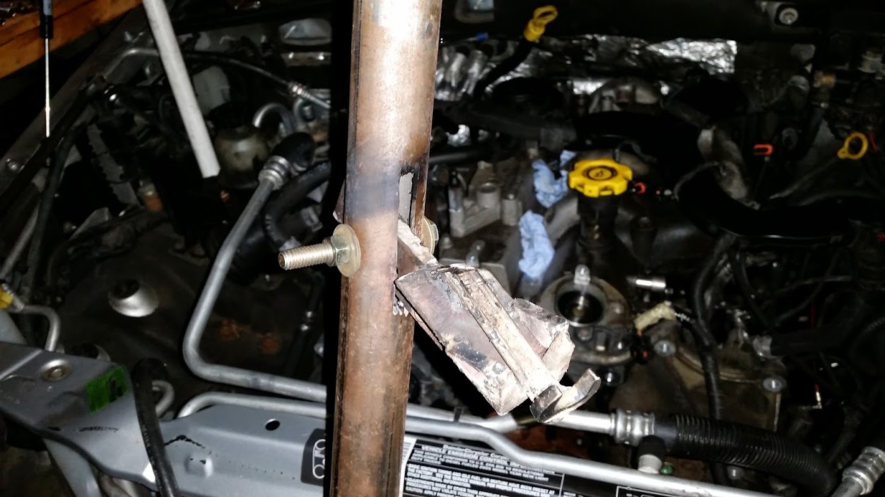

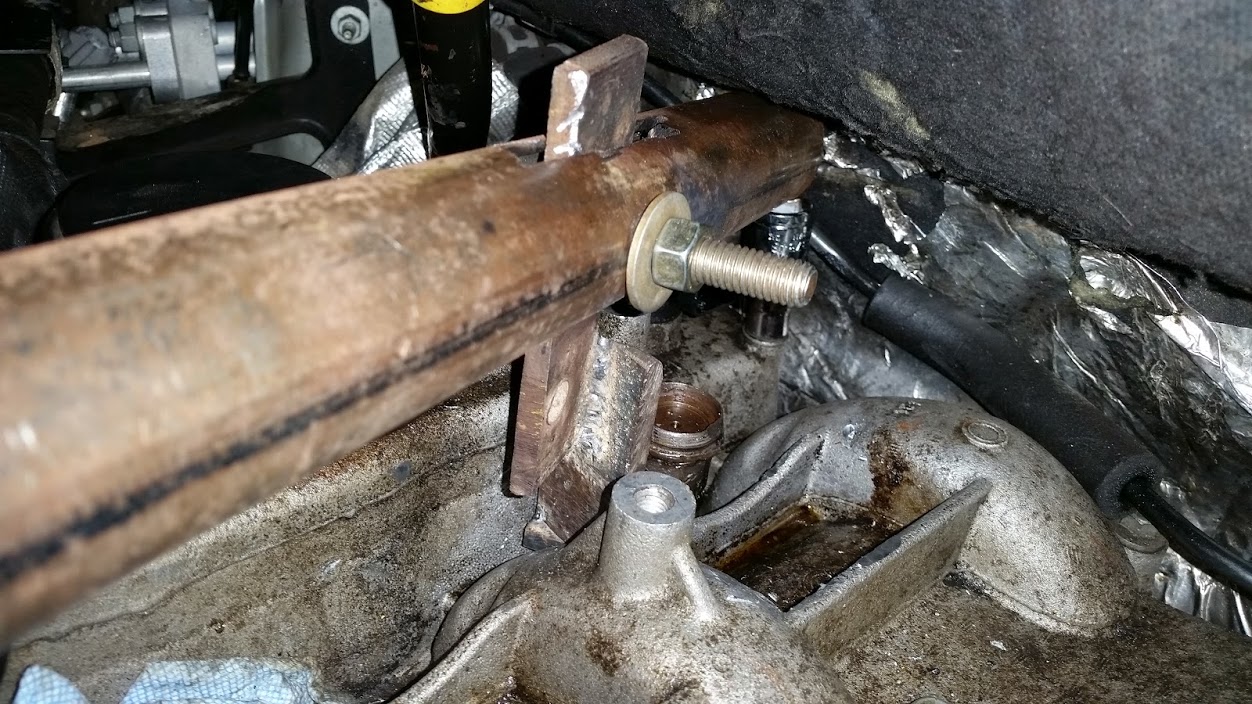

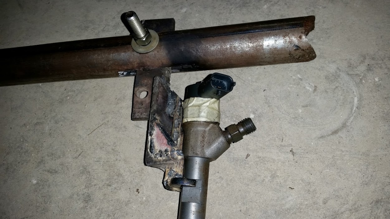

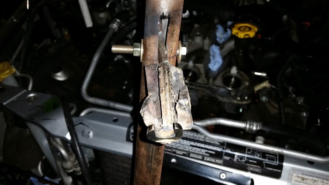

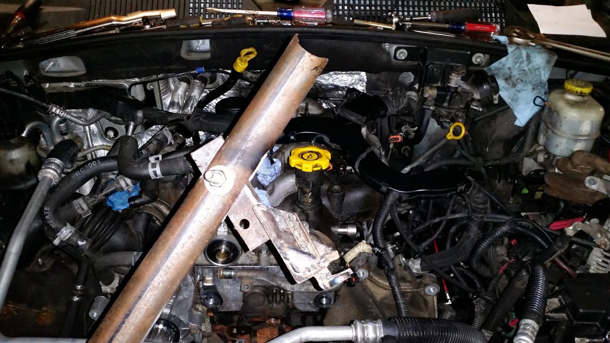

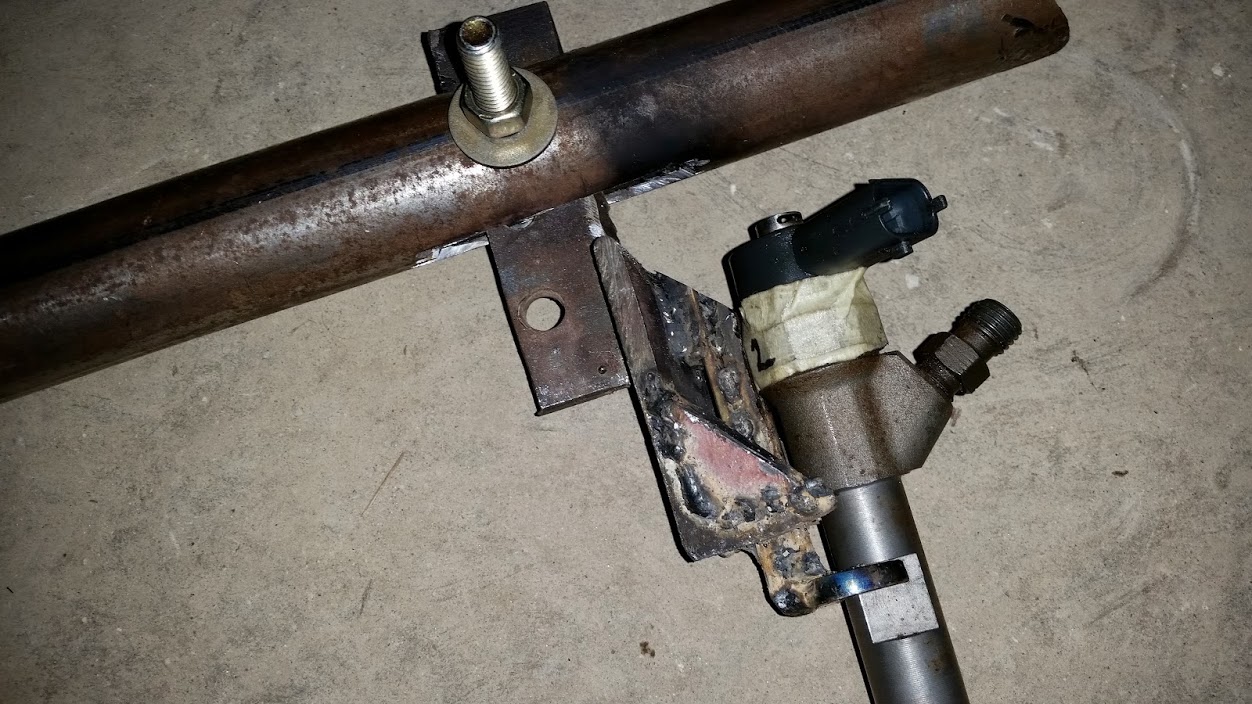

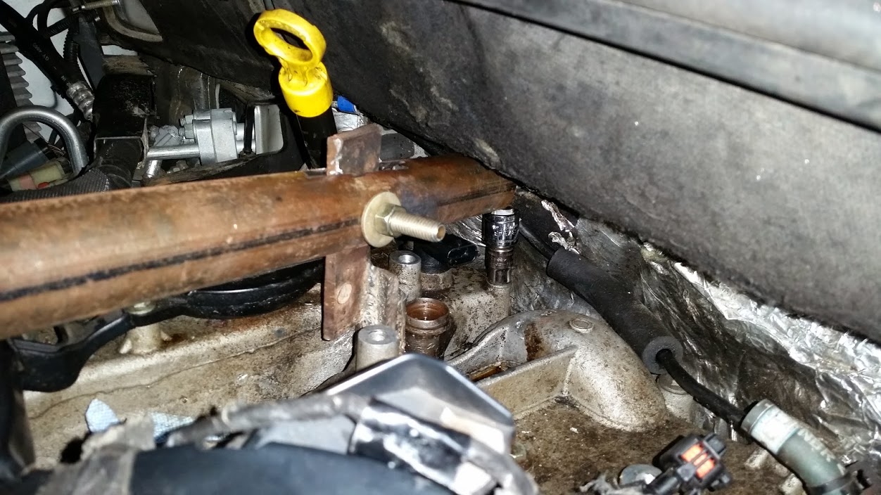

I have tried pliers (not a pipe wrench yet), but the problem is not getting it to spin, but getting it to slide up and out. I have spun it in both directions, I can't spin it all the way around because the part where the fuel line connects hits the exhaust side of the cover.
Here are some pictures of the "tool" I made, essentially a 1/2" wrench welded to some plate which pivots on a bolt through a pipe, I was pushing up on it with the end pressing on a socket placed on one of the cover bolts in back. Either I would have someone else use a pry bar to hold the "tool" on the injector, or I had hose clamps around it and the injector holding them together.

It's hard to believe it'll twist, but won't come out, makes me wonder if the tip is damaged, or has built up crud on it? Have you tried taking the valve cover off? It might clear the injector since you have the solenoid part off. If you can get that off I'd take the head off and go at it from the other way. Worst case you destroy the nozzle and need a new one.
