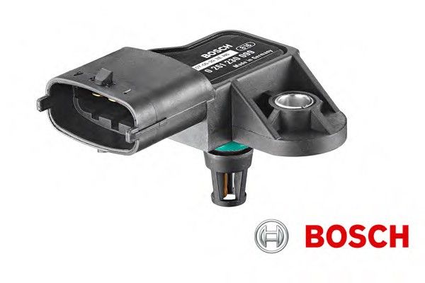

OK, I'm pretty sure I've tapped out the map sensor. Started thinking about how to find a higher rated map sensor. First thing came to mind was Cummins, and there's guys pushing 40-50+ boost in those engines. After some searching I came up with this: http://www.genosgarage.com/CUMMINS-4921 ... -WKc3PD_qA
Looked it up on Napa online and they have it, so gonna pick it up tomorrow and see if it'll work. Looks identical to ours, just rated higher and costs 2x as much.
If it'll work, I don't know, but I'll try it. Only thing I see is it will bolt on backwards.
 Post subject: Re: map sensor (in)accuracy
PostPosted: Fri Aug 08, 2014 11:33 pm
Posts: 571
Location: Republic, Oh
Found another one, made by Bosch, that is perfect. I just can't find how many bars its rated for.
PostPosted: Sat Aug 09, 2014 9:34 am
Posts: 571
Did a bunch of research and reading last night. I'll just note the couple important things I learned.
There's map sensors, and there's tmap sensors. The t designating temperature measuring, which is what the crd uses. Also the "a" means absolute (duh me) pressure, meaning it measures from true 0psi (30" of vacuum).
The stock sensor is a 2.5 bar sensor. For those who don't know a bar is one atmosphere of pressure, 1 bar = 14.7 psi. Measuring from 30" vacuum up 2.5 bar puts us at 22.05psi. It won't read after that.
I found a 3.5 bar (good up to 36.75psi) sensor that will swap right in. Only thing I'm not sure is if the computer will have to be tweaked to read the higher scale. Already ordered it so should be here next week. Kinda excited to see what the jeep does when it can finally see 30psi of boost.
