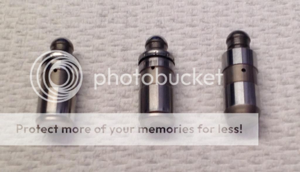

Okay, here are pictures.
On the left is what I call "solid." The ball part of the joint between it and the rocker rotates, but does not go down into the plunger body. I have not tried putting in a press or anything, but the others move by hand pretty easily. Pressing it and tapping it pretty firmly with a piece of wood does not "free" it, and it seems like an odd environment for it to seize up in, given the constant wash in oil.
In the middle is one that looks almost exactly like the first one, but the ball part of the joint does recess into the plunger when you press it.
On the right is the design with the tapered bottom. This one also compresses.
I don't know how these things work, really. If the plunger "floats" inside the cavity that it fits in in the head, using oil pressure to keep it in place, why would it need a spring-loaded section at all? If that isn't how it works, how does it?
And again, is there one design here that is better, or one I should watch out for as being incompatible?

Usually what happens is some dirt gets inside which jams up the plunger or the check ball.
Sometimes you can soak them in diesel fuel or solvent to get them to free up.
The two on the left look like an older design with a retaining cap crimped onto the body.
The one on the right is a superior design with a retaining clip inside the body.

If you ordered from idParts I suspect you would get the tapered base ones which is a newer design (the 06 parts manual lists a PN with an AA suffix while the idParts site has the same PN but with an AB suffix indicating and interchangeable but redesigned part).
I cannot find them, darn search function, but there have been posts discussing the compressibility or lack thereof for the lifters. Seems that soot in the oil can cause them to freeze up and IIRC correctly the early version of this part can be opened up and cleaned to restore compressibility.

You should be able to stick a very small allen key or pin through the top hole of the lifter and that will open up the internal check ball allowing you to compress the lifter, and push the oil out. Not a good idea to stick them in a vice, and definitely not a good idea to stick used lash adjusters back in the head without collapsing them first! It is absolutely normal to be unable to collapse the Lash Adjuster just by simply squeezing it by hand unless you push a pin in it. BTW, That wiki article is garbage for telling you to fit them full of oil, that's how a valve gets stuck open and hits a piston! A little bit for lubrication is good, but you want to be able to squeeze it when you re-assemble

Also, those are two different designs but work in the same bore, one having a stamped cap to keep the guts in, and the other uses a very fine internal snap ring. This was a failure point on my CRD when I bought it broken. Timing belt was still in time, but several lifters had fallen apart and caused the rockers to fall off. I had the internal snap ring style and this all happened at 98k miles. This is why I urge everyone to do rockers/lash adjusters at 100k. Several rollers were pretty much seized as well.
Really?
I would think the snap ring would be better than a crimped on cap.
Or was it the siezed rollers that caused the lash adjusters to break?
IDK exactly which ones IDparts sells but the picture on their website shows the tapered bottom.

Here is a thread with some pics comparing old and new lash adjuster.
http://www.lostjeeps.com/forum/phpBB3/viewtopic.php?f=5&t=74904&hilit=rockers
Even shows one with a broken crimp cap.

Excessive soot in the oil is not good for the 'lash adjuster' and the support pin for the roller on the rocker arm is also worn by the soot. Marginal design at best.

Instructions for installing new hydralic lifters are very specific: put them in a cup filled with engine oil, manually compress each lifter until unable to do so, then install - this 'pumps up' the lifter such that it can fulfill its function against valve spring tension - being full of oil , pumped up, will not cause the valves to hit the pistons
FYI: most shades, of which there are many on each and all forums, do not have the strength to compress a properly lubricated lifter, new or used, unless using a lifter test jig, designed for testing internal plunger and valve leak-by, where plunger-to-bore fit has exceeded design spec, or\and valve-to-seat fit is deteriorated past max spec
Crimps or snap-rings have finite life span, much as do the valves\seats, resulted by the constant "hammering" action - the internal ring does allow disassembly for inspection, but it is much easier to replace lifters, and cheaper in the long run by preventing future failure for a 'nuther 60-100kmi, or whatever your personal service schedule - early Diesel engines used solid tappets with specific valve adjustment intervals, usually involving removal of injector pipes to remove the valve cover(s), and manufacturers were reluctant to utilize hydraulic lifters due to precise valve-timing constraints, and sticking lifters due to sooty engine oil - sticking lifters will cause offset cylinder timing variation, which affects combustion temperature, which affects efficiency - valve timing is critical in Diesel engines - the ECU can now compensate for this, but was not available in those early times
Valve timing is also critical in gasoline engines, which is why solid-tappets are preferred, flat or roller, with adjustable rocker arms, for racing engines

Take notice of gmctd. When you assemble the engine, the lash adjusters should slowly compress to allow possibly all the valves to sit on their seats.( depending on cam lobe position - not 100% sure the collapse of the adjuster is sufficient to negate all of the valve lift ) Hopefully you will not have the engine on TDC or the valve will rest on the piston top as you fit the cams and cover - something could break as you tighten the can box down. Have not read the book on this but the design suggests this scenario. If the crank is at 90* after TDC as for doing the timing, the valves are clear of the pistons. As you fit the cam box, the adjusters will gradually collapse to allow the valves to sit on the seats. The collapse or leak down may take 5 to 10 minutes. I have not looked up the particular specifications, but am going on experience on 30 year old engines with hydraulic lash adjustors. When you start the engine, the oil pressure will quickly pump up any adjusters that have slack between them and the rest of the valve train. If you bleed any oil out of them, it will be replaced by air and on startup, you will have a noisy valve train until the air is replaced by oil - sometimes takes many minutes.

Correct - hydraulic lifter design specs clearance between plunger and barrel to allow some leakage -this cannot be overcome by hand pressure, but can be seen as valve train is assembled - the leakage serves to allow automatic adjustment to spec'ed valve clearance at normal engine oil-pressure operating levels
BTW, the internal spring is to ensure correct positioning of plunger and valve prior to oil fill

Interesting. So I verified that I can "free up" the lifters that I thought were solid by putting a thin rod down the socket hole and finding the valve near the bottom of the lifter. What amazes me is that these have now been out of the vehicle for several weeks. I guess they are working properly.

Correct, and my bad - I used the term hydraulic lifter - hydraulic lifter design consists of a barrel-type 'tappet' with internal hydraulic valve lash adjuster.........................
