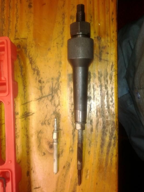

You're correct on the thread. I am willing to bet that the head just needs a tap ran through it. Just use lots of grease on the tap to hold the thread filings from falling in. You may want to pull the injector and blow compressed air into the cylinder toblow any loose crap out of the glow plug hole. Just went through this process last weekend except I actually had to extract a broken glow plug.... It had a happy ending though! Jeep runs like a top and didn't drop a thing into the cylinder head by taking lots of precautions.
