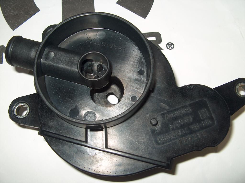

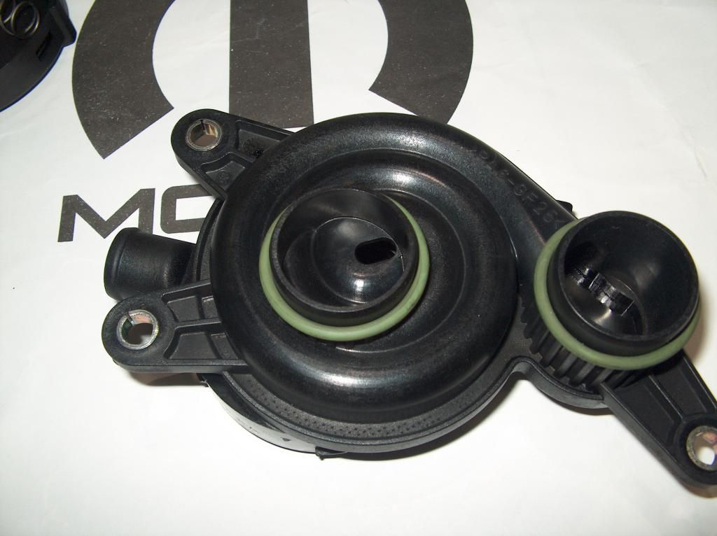

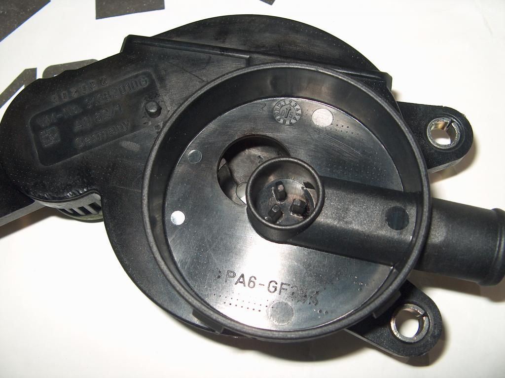

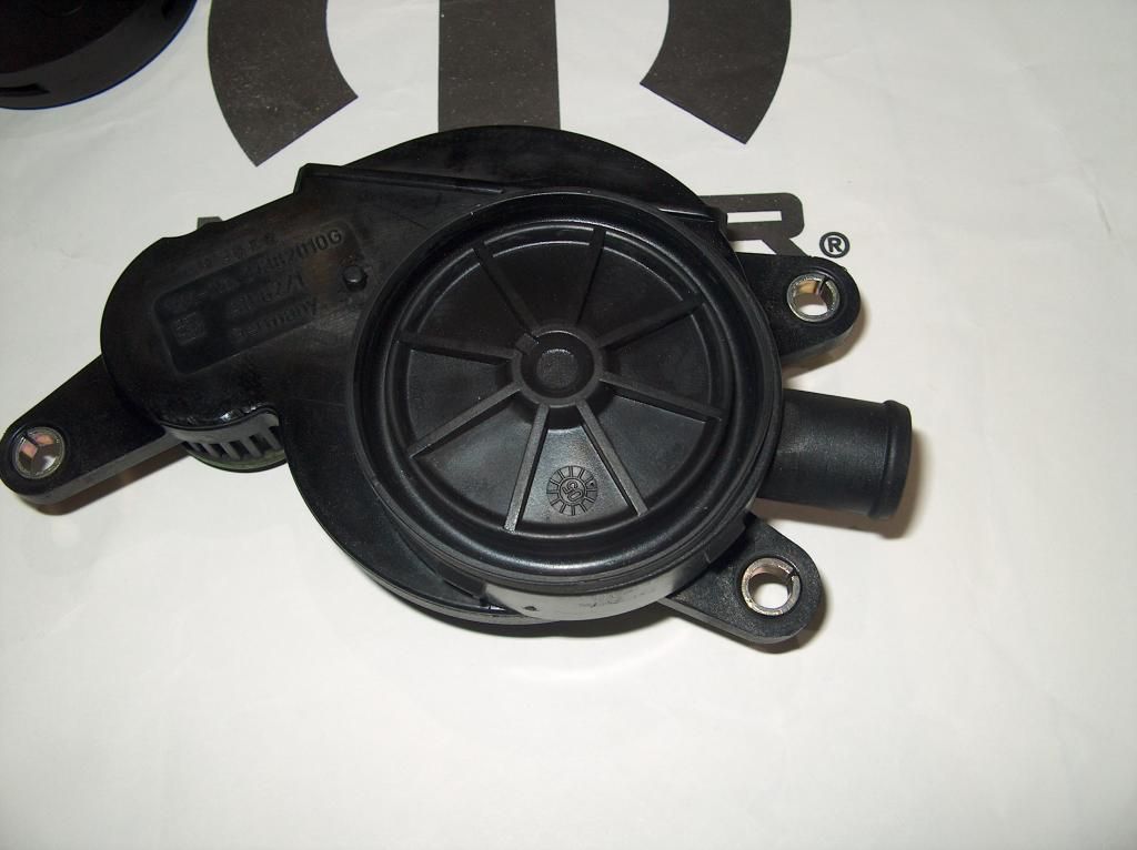

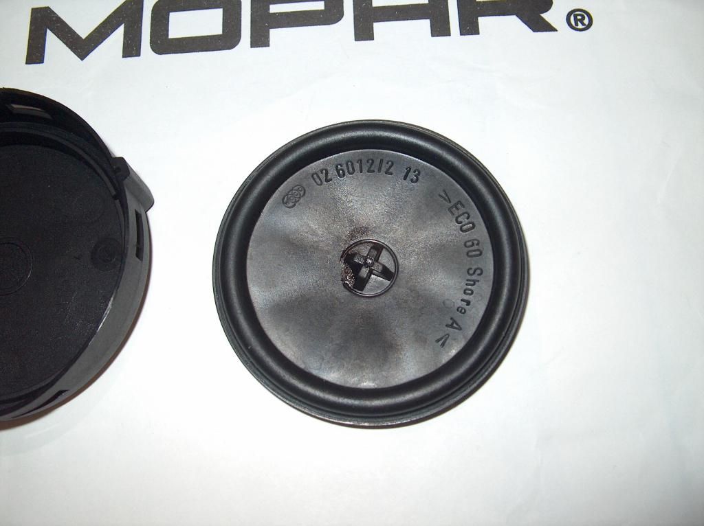

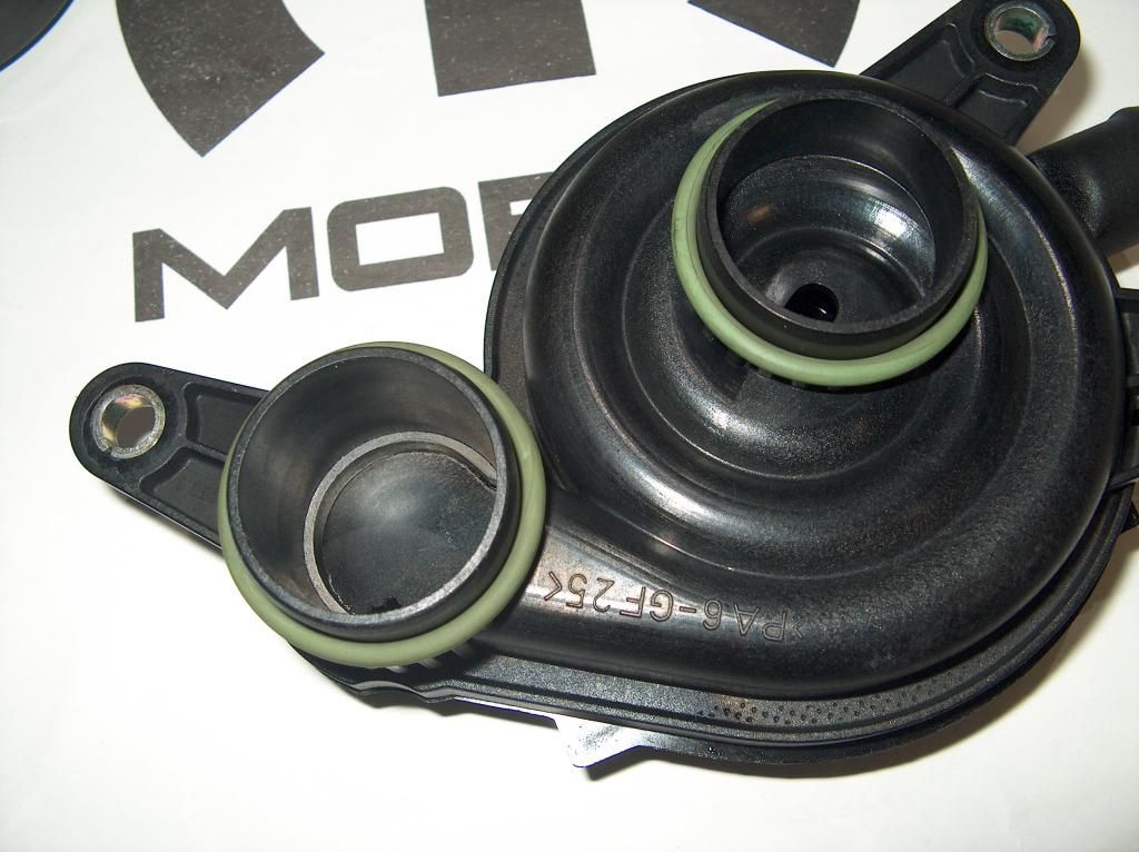

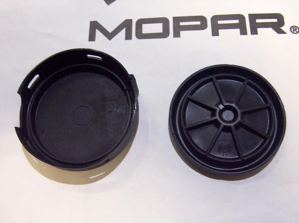

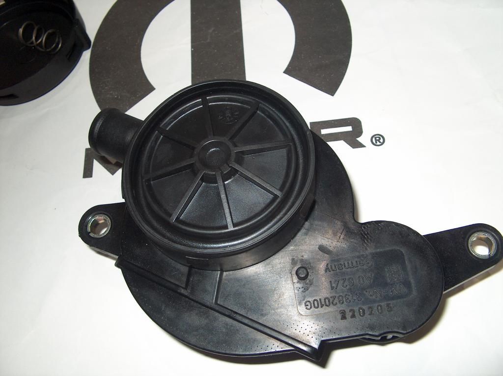

Engine cover showing front and rear CDR ports - rear of engine is to left - MAP sensor top left - Cam Timing Sensor lower left:
CDR with 'puck' cover off showing BARO-side of diaphragm in-place:
Rotated view:
Engine side showing metered front port at center\exit of centrifugal scroll:
Rotated showing unmetered rear port to entrance of centrifugal scroll:
Top showing vacuum chamber with valved exhaust\vacuum port to compressor inlet duct:
Rotated showing scroll center-chamber port into vacuum chamber with metered passage to front port below:
Showing diaphragm helper spring as located in exhaust\vacuum port:
Puck cover down-side up on left, diaphragm BARO-side up on right:
Diaphragm vacuum side, ECO A with compliance of 60 Shore:

Thanks much gmctd, now we all know whats in the mystery puck on top of the little smoker!!!! :P
Great Information, and the design makes sense after studying the pictures.
One question, would there be any benefits to gain by removing the puck and carefully taking it apart and giving it a good cleaning??? :?:
