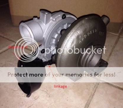

I did pull the vac line off the vac module on the turbo and it has vac at the line, but the rod did not drop when unplugged. It does not move up the 1/2" it should when plugged in at idle either. I am however able to move the rod by hand. I hook up an hand vac pump to the vac module on the turbo and it moves the rod briefly when i squeeze the handle but fades very quickly. It bleeds off so quickly that i cant build any vac past 5-7in/hg. Is this vac module my culprit? I called the stealership and they said they dont sell parts of the turbo.

I want to make sure I understand what you're talking about: the round, metal-encased vacuum diaphragm that directly controls the linkage rod to the turbocharger vanes and is attached physically to the turbocharger, which is attached to the engine?? Is that what you are applying vacuum to, and then seeing it leak from?
If so, it sounds like you have a hole in the diaphragm. Unless you are re-using the same piece of vacuum line for the test and the line has a leak.

Again, important to clarify what component you're talking about. If it is the linkage that I described above, yes, that varies the angle on the vanes. As for parts availability for that specific part, I don't know; I believe it is calibrated against the rest of the turbocharger, so it may not be available separately.

Lost junkie, yes I am talking about the vac diaphragm on the turbo. I did use the hose supplied with the hand vac pump. There is suction at the vac line that normaly is hooked to it while running so I think the diaphragm does have a pin hole in it. Any idea on how to calibrate a new one or just get a new turbo. And if new turbo, where is most people buying them for decent price?

I suspect you could not get that part alone from a dealership. I doubt there is a published method for calibrating it, but you might get lucky if you called Garrett and sobbed on the right shoulder. Who knows, they might even sell you that one part. But I kind of doubt it.
I believe the positive pressure side of that diaphragm is exposed. If it can't be bought separately, and if it were me, being cheap and with nothing to lose, I might start looking for a way to patch the pinhole. For example, flexible silicone conformal coating, or even the green Slime used to patch inner tubes. You might get lucky, especially with the conformal coating.

Sorry greiswig i just glanced at your post and missed your profile name. Yes the vac diaphragm I believe is the culprit. I do believe it is crimp sealed together so i might have to search for a new one or new turbo.

Call GDE sometime today, I should have a couple diaphragms available off older turbos. Most likely about $50 shipped. Don't pull off the old one yet, you need to take some pictures first. Put a vacuum pump directly to the turbo actuator, it is does not hold vacuum, then the unit is failed.
There is a lock nut to hold the control rod length constant. You will want to measure this length and then compare to a functional part.
