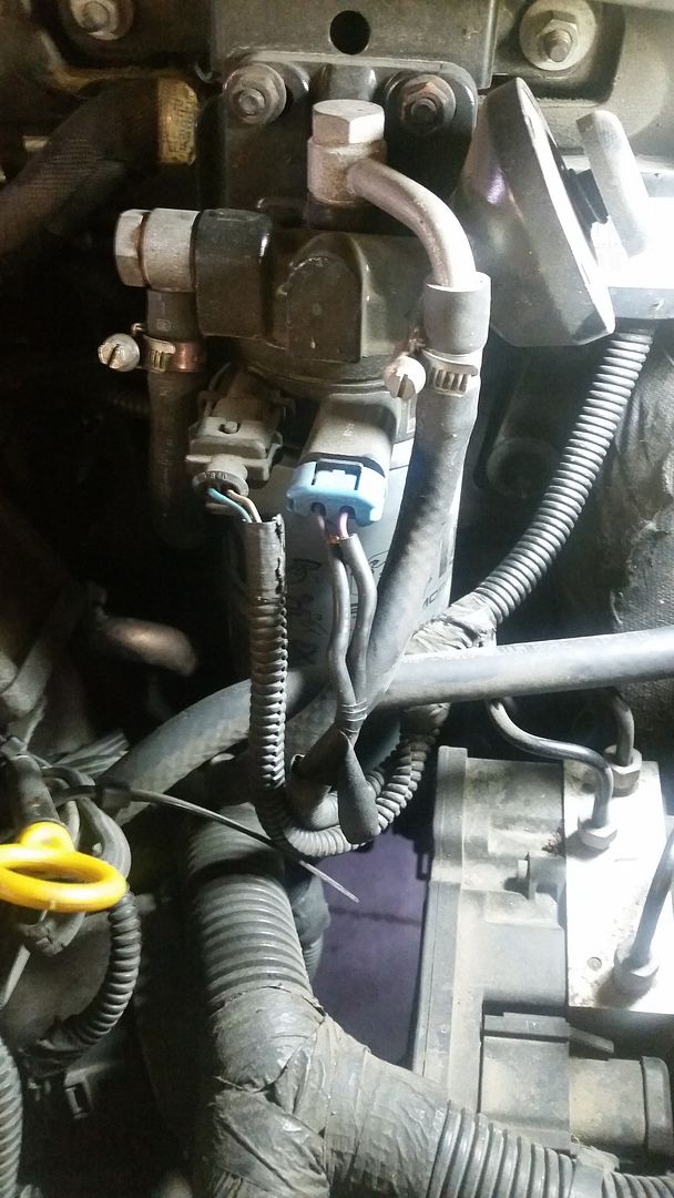

I assumed the filter head was changed out due to some nice shrink wrap on the right side plug-in pig tail. But it is blue
The fuel filter is a Mopar filter. My gf took it to the local jeep dealer to get oil changes, I have no clue if they have changed it. I can't seem to be able to get it to spin off. I sure don't want to break the plastic housing it has.

Yep that's the 2n gen filter head which is good.
Removing the filter can be a bit of a bear. First off remember it has a WIF sensor on the bottom whose wiring pigtail must be removed before trying to remove the filter and that the small inner filter gasket (fits around the threaded shaft the filter screws onto) has a tendency to not come off with the filter so be sure to remove it.
If you can get a filter wrench in there it should come off remembering of course that it's upside down so when looking down from the top you turn the filter what appears to be clockwise to unscrew.
Frankly I prefer to unplug the top electric connections; loosen the hose clamps and push - don't pull - the fuel hoses off; undo the 2 bolts holding the filter head to the base plate; lift it out enough to unplug the WIF wire; and then do filter removal in a bench vise.
