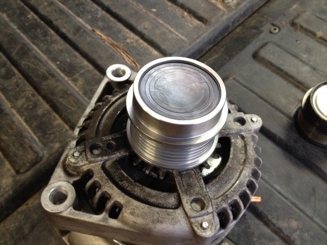

What alternator part number did you put on the engine?
Does it have the one-way override pulley on it? Sounds like based on your issue; it does not.
Also note, a weak or work out belt or belt tensioner can also cause "chirping".
Many use this OAD Pulley: Litens 920720A
What does an OAD™ pulley do? wrote:
An OVERRUNNING ALTERNATOR DECOUPLER™ pulley helps "synchronize" the belt drive system for improved engine efficiency, reduced Noise/Vibration/Harshness (NVH) and increased component life.
When an engine accelerates, the alternator's mass creates resistance against the belt. In addition, due to differences in drive ratio between the crankshaft and alternator pulleys, alternator speed is typically three times faster than engine speed. These factors often cause "rope-tow effect" in which belt speed and alternator speed are out of phase. Belt tensioners can absorb some of the resulting vibration, but the belt ultimately bears the brunt of this damaging force.
An OAD™ pulley features a sophisticated internal spring and clutch system that absorbs the force associated with belt accelerations and tension reversals and permits the alternator to "free-wheel" or "overrun" when the belt suddenly decelerates.
It should look like this on your alternator with a plastic cap over the end of the pulley if it is a OAD pulley.
