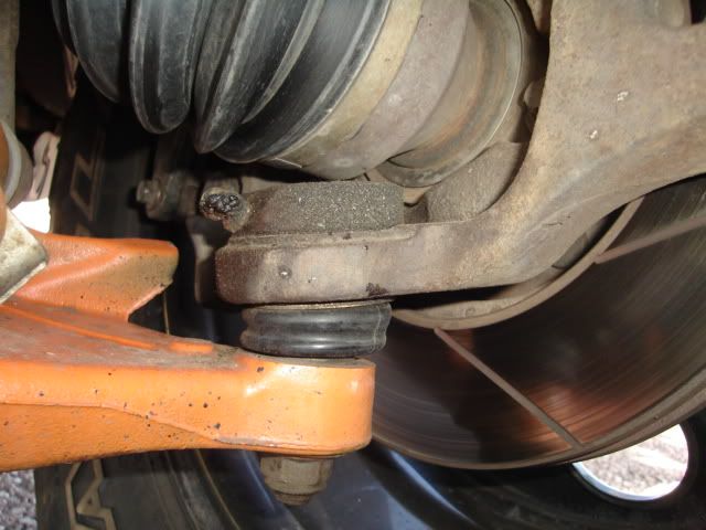

Anyone had the lower ball joint have a catastrophic failure? This one came completely out of the socket and the lower a arm dropped. The ball joint bolt cut the rim like a lathe. Good thing the wife was not driving however during this whole event the Jeep handled quite well.
My question is during this some lube leaked from the transfer case from around the shaft do I need to do anything other than check the level of the lube?
I don't want to put this whole thing back together and find the shaft leaking would it need a seal replacement?
John

Glad you're OK. I was thinking it looked like the tie rod would keep it from folding upward if the LBJ gave out last time I had it apart. Still, not a good failure to have though.
-- do you you mean around the CV shaft? When the boot tore on mine it threw grease all over the brake components, suspension, etc. If that's what you're seeing, check the CV boots. If it's the front drive shaft coming from the transfer case, it might need rebuild. Check google...there are examples of broken ones and the rebuild process with youtube videos.

The lube came from around where the CV shaft inserts into the transfer case. That's best I can tell. Everything seems to rotate well. I will check the boots just to make sure the are not torn.
Thanks

unfortunately - that's a standard Liberty thing - it's why 'check your ball joints' is a sticky
http://www.lostjeeps.com/forum/phpBB3/viewtopic.php?f=3&t=4348
and why Jeep has had at least one, if not more recalls on them.

Are you referring to the transfer case behind the transmission, or the front differential housing with the two cv-jointed half-shafts?
If the front differential, likely the exaggerated angle resulted when the lower ball-joint let loose caused the leak - could require the diff axle-seal replacement.
Make sure they install the K3199 ball-joints required for the heavier CRD KJ, rather than those for the much lighter oem spark-infested KJ

You do know that the OEM LBJ's are also MOOG part#K3199.The "problem solver" series K3199's are the greaseable HD versions of the K3199.

I do know that somewhere on this site is the comparison of the K3199's to the small oem versions I replaced when I did the upgrade on my KJ , in another time, another century

As can be seen, and considering that they did use the correct pictures of each, the currently-listed K3199 is non-greaseable, and is the type I replaced
You may also note the model year useage is '02~'04, with '05 mention.
The K80767 is greaseable, and is the heavy-duty unit I installed - for some reason they were being sold under, and we were told to ask for, the K3199 number back then
Dunno if the dealers are conforming to this upgrade requirement for the heavier KJ CRD chassis, but the differences are easily notable by visual comparison

MOOG changed the part # fort he "problem solver" K3199's,was confusing to have 2 different parts with the same part#.Some parts houses still list the "problem solver" series K3199's since they still have them in stock with the part# K3199 on the box.

Good information, all, and after many years, the reason for my apparent MOOG "confusion" is exposed, revealed, and resolved
So, if footing the upgrade bill yourself, open the MOOG K3199 box at your local automotive emporium, verify that it is the exact duplicate of the K80767 picture, and has the required zerk fitting enclosed, therein
You will also note that it is much heavier, more robust, being the heavy-duty version for larger, heavier vehicles

I believe they are the same part. I'd suggest the K80767 since it avoids any confusion and it guarantees you a greasable joint.
A quick search indicates that the K3199 is made in both greasable and non-greasable versions and it can be a bit of a crapshoot which you get. I've seen more than one post commenting that they have believed they were ordering the problem solvers and ended up with non-greasable K3199s.
