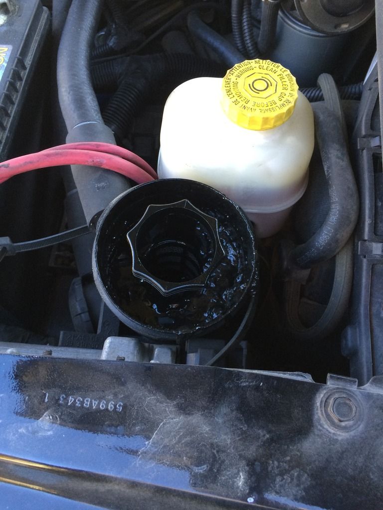

I have recently got new rockers and ARP headbolts along with weeks kit 1 &2. The following morning i noticed EGR parts fell from my Jeep. So my question is the main culprit being gone, do i still need Provent CCV kit ?
I mean after two years this is what happened last winter.
It clogged badly into tar like gel and Jeep gave me DTC P0101& P0299.
Besides there has to be a better solution than spending 90 USD on this every winter.

The provent is not necessary.
It just helps keep oil out of your intake hoses and intercooler.

With the EGR gone, the soot source has been eliminated. That muck looks like a lot of soot mixed with oil. I bet if you have fresh oil and no EGR, you will not see sludge buildup in your provent anymore.
Oil in the intake track has never bothered me. It is the soot from the EGR that is the enemy.
