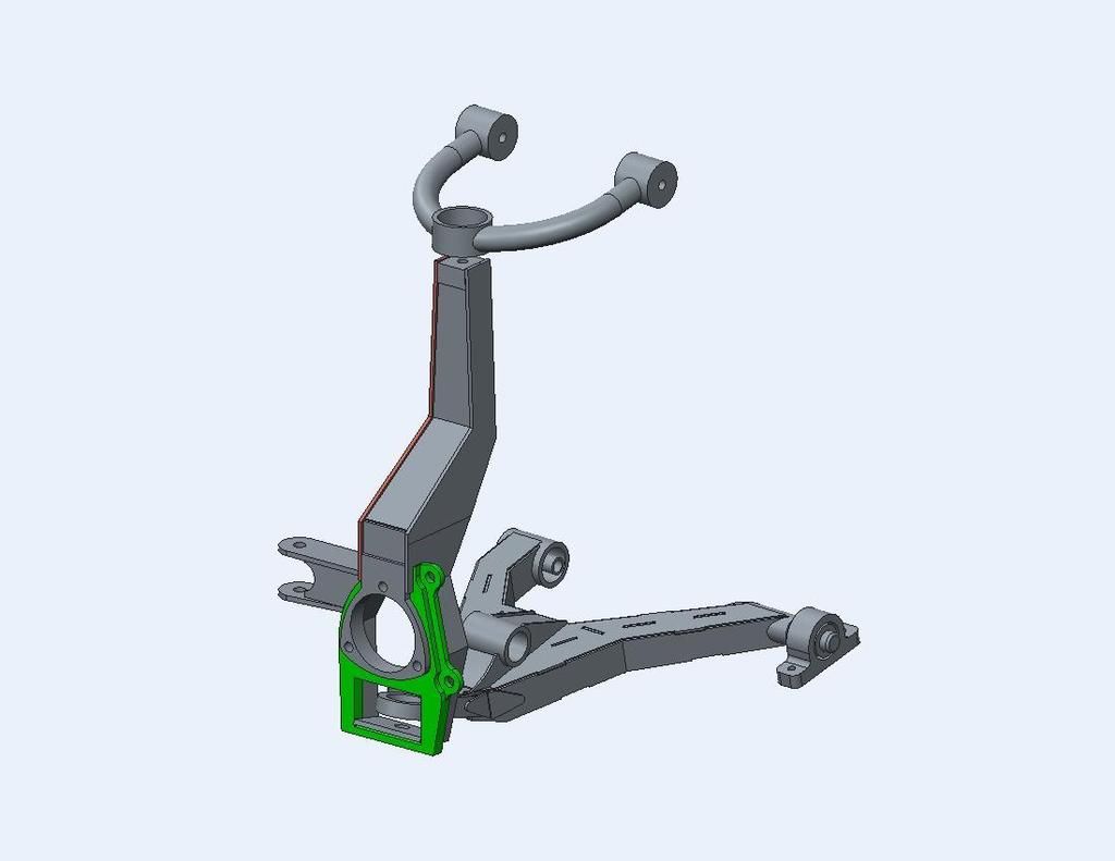

I have thought of doing something like this. I am more leaning to using a Dana 35 hub assembly from a TTB Ranger and building my own Spindle with wider upper and lower control arms. This would keep the same wheel bolt pattern. Not sure if the stock rims would work or not.
This is kind of what I am talking about. I am measuring the stock KJ parts, but don't have anything drawn yet.
