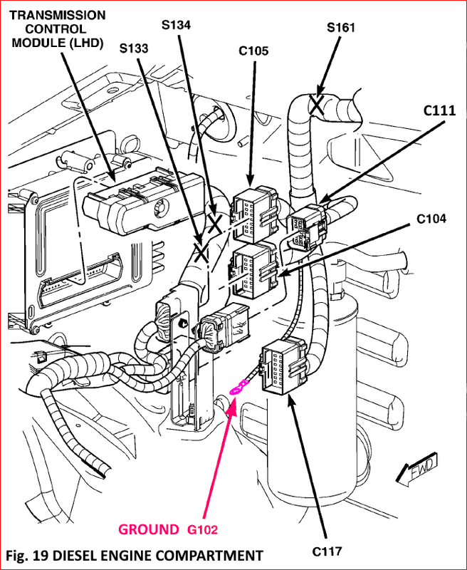

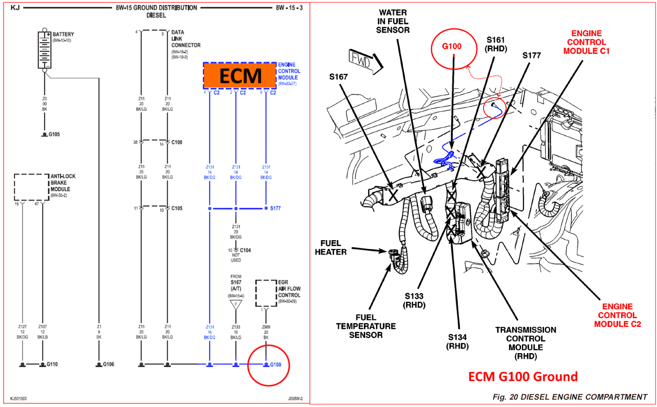

Grounds:

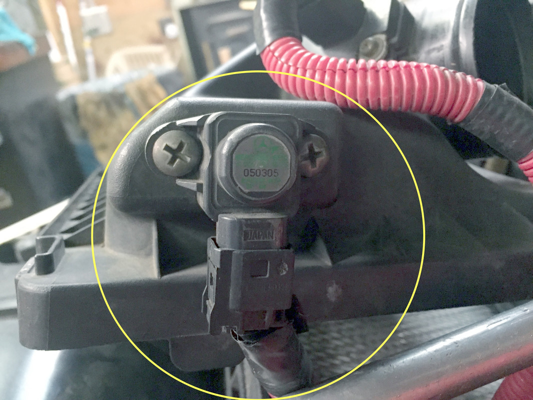

IAP sensor – OEM part no.: 05101120AB
(intake air pressure sensor on side of airbox)
air inlet air pressure comparator pressure sensor on the side of the air box;
sometimes referred to as the “Mercedes sensor”
• Bosch part no.: 0261230189.
• Mercedes OEM part no.: A0051535028
• Autozone part no.: 0261230189
 Post subject: Re: P0069 and P1854 problem
PostPosted: Mon Jun 06, 2022 4:02 pm
Joined: Wed Apr 15, 2009 3:31 am
Posts: 62
Location: Italy
WWDiesel wrote:
giacomo.m wrote:
Hi,
someone knows the Bosch part number of airbox pressure sensor( mercedes ) ?
thank you
Giacomo
that's perhaps where the problem lies
a few days ago I told you I had mounted the A0061539828 (Mercedes )but no one told me that instead the sensor to be mounted is A0051539828...
tomorrow I try to fit : 0261230189 Bosch and let's see how it goes
