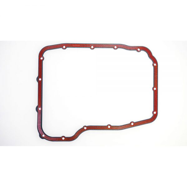

Spin on filter is inside pan along with the flat suction filter. You will see it when you drop your pan.
Use the gasket along with some spray Hightack sealant on both side of the gasket.
or
use silicone only by it self, but do not use silicone on the gasket as it can make it squeeze out when you tighten the bolts.
Do NOT overtorque the bolts when using a gasket, it can damage the gasket.
or
If you want the very best oil pan gasket made, get a LubeLocker Transmission Gasket PN: RFE- LLT-CRFE, it has silicone embedded into the gasket material.
https://www.lubelocker.com/products/chr ... e-llt-crfe
It is the very best gasket for pans and differential covers I have ever used, fully leakproof and reusable. See picture below.
RFE- LLT-CRFE Chrysler, Jeep, Dodge RFE Transmission. Also Fits 68RFE, 66RFE, 65RFE, 545RFE, and 45RFE
