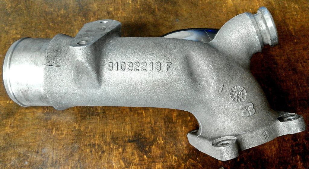

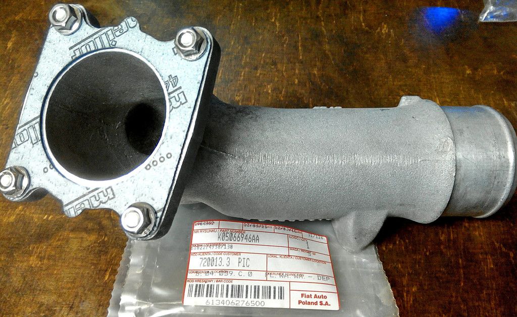

Hi everyone,
I recently stumbled upon a 2004 Liberty CRD manifold intake pipe from the European market, the part number being 91092218f. It's interesting because it's a one piece design without the FCV, just a small EGR port on the side, hence seems ideal for deleting EGR on the 2005+ cars. Seller says it's from a 2.8 CRD (there were less powerful 150 bhp versions sold in the EU till 2005), however I can't say for certain if it's not from an even older 2.5 VM CRD. Anyways this looks like it should fit the EGR equipped 2.8 CRD and if so could be a simple way to delete the recirculation system altogether. Did anyone have experience with such a solution (would like to confirm prior to buying and stripping the EGR...)?

wow, it's the weeks intake kit with an egr port. Prior to FCV? hmm, I guess you'd need the bolt spacing and the internal diameter of the tube to know if it would fit. Might also require a longer CAC hose, but it looks pretty long.

So I see that it is not something that was discussed here or tried before? If so I'll just get one of these and see how it fits (when I'll have some spare time for the jeep that is...).
Mountainman wrote:
You familiar with Sasquatch Motorsports intake elbow kit? It might be a better route for you.
Yes I am, however frankly I never intended to remove the EGR entirely, just disabled it fully and removed the "flap". The above solution did interest me though - for the sake of the exercise I guess :roll: And I'm getting a strange feeling it might fit ;)

Pre 2005 CRD has no FCV. It will bolt onto the 2005 on camcover/inlet manifold. Samco make silicon hoses to fit on the older 2.8. The EGR is not so effective on the older version hence why they tend to more reliable. Personally I would go with the weeks elbow.

Unfortunately I couldn't find a decent photo of the other side of the engine but I would suspect the egr system on the -2005 CRDs would be controlled by a volume valve or similar (as is in case of many older cars).
Mountainman wrote:
I wonder if the part can be found online other than the occasional Ebay listing? Any idea how much one can be found for?
No idea how accessibility looks like in the US, I got mine locally for under $20 including shipping :)

That intake elbow in the OP's first post has an EGR port. It looks like it is in a different spot compared to mine, but the port is there.
Yeah, there seemed to be two kinds regarding EGR port orientation. I got mine today, will match it to the OEM gasket in the evening. EGR port is under 1" ID and I will either weld it shut or tap and blank with a short bolt and some thread sealant.

Well we'll see - it'll most probably be some time till I put it on the car but I will post feedback regarding ease of installation and accessibility. One thing is certain - I will be using studs with nuts instead of bolts which should facilitate things a bit. So far I can add that the pipe's flange fits the 2.8 CRD OEM gasket :) Furthermore the pipe's exit is 63 mm in diameter so slightly smaller than the FCV equipped car's (65 mm from memory?), which is actually perfect for my intake.
And two photos for reference:
