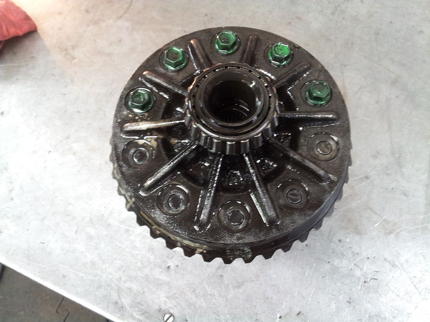

I found quite the surprise when changing my pinion bearings yesterday. Half of the ring gear bolts were sheared off and amazingly did not damage any of the gears. You may want to check yours next time you are changing the fluids.

Were the heads in the bottom of the case?
Yes, Three bolt heads were near by the pan and the other two were up near the yoke. I can't believe they didn't find their way into the gears when they were bouncing around.
