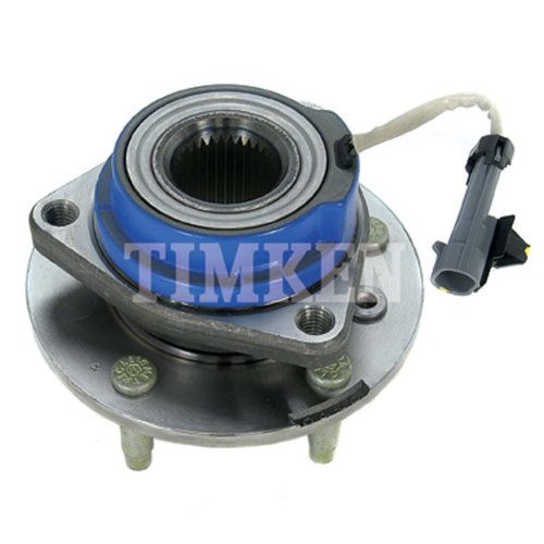

I have my 05 KJ CRD Limited (which has ABS, Anti-lock Braking System) on jack stands, and I'm in the process of doing the replacement of my front Hub-bearing-units. I have held-off installing them due to a concern about the new unit I received: upon unwrapping it, I found that it has no sensor wire or plug attached to it. DOH! :banghead:
Listed on Amazon, I purchased these Timkens https://www.amazon.com/gp/product/B000BZ53U6/ref=oh_aui_detailpage_o01_s00?ie=UTF8&psc=1, it showed that units had the sensor plug all attached and contained, like this one:
Sadly though, when the ones ordered arrived, they didn't have any sensor cord pack attached to it like the photo above, nor any sensor wire or outlet at all. I guess I ordered the Non-ABS version on accident. Dang those inaccuracy photos! :furious:
Anyone know where I might be able to get the ABS Sensor versions on Amazon or somewhere else, ideally a high-quality and reputable brand (Timken or the like).
Any part numbers available?
Thanks in advance!
Sarma

I found this site that lists many different Hub/Bearing units, and they differentiate between ABS and Non-ABS, so that's good. But I wonder which ones I should get:
http://www.partsgeek.com/catalog/2005/jeep/liberty/driveshaft_-ar-_axle/wheel_hub_assembly.html
The parts numbers listed on the Timken's with ABS and 4WD are as follows:
2005 Jeep Liberty
#18363-05190640
Wheel Bearing and Hub Assembly
Are these the right ones?
Thanks in advance.
Sarma

Go with whatever bearing you like as long as it's for ABS.
I got mine from Advance auto parts.

rockauto.com. they have many brands to choose from. timken, mopar, skf and others. they timken for abs is $132.79
http://www.rockauto.com/en/catalog/jeep,2005,liberty,2.8l+l4+diesel+turbocharged,1431569,brake/wheel+hub,wheel+bearing+&+hub+assembly,1636

Thanks flash7210 and peteyz24 for the reinforcement and the resources.
I ordered some Timkens with ABS cord/sensor-plugs today.

I got mine recently from the company that makes this video, www.a1auto.com. The install was exactly like in the video, and they came in a pair with the abs sensor connected, and ready to plug. I am satisfied with about 1000mi on the new ones. The hub bolts are e-14, or something, I ended up getting a universal-type socket set to get them off, but reverted back to the 12pt, and it worked too. also, you will need a 35mm socket for the axle nut.
