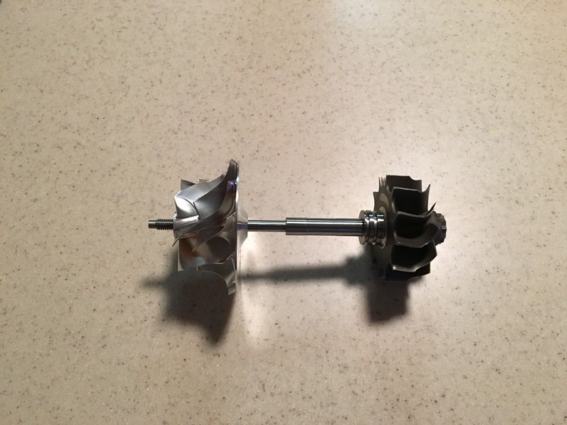

Ive been mostly in discussion with the bearing manufacturer, but i did get my brand new turbine wheel and the dieselsite wicked wheel2 billet compressor wheel. I didnt get any pics of the new wheel next to the old wheel, but heres a shot of it and it installed on the new turbine wheel.
Right now the bearing surfaces of our turbine shafts measure 7.88mm, or 5/16". The bearings i want dont come in sae so its metric only. The first idea was to precision grind the turbine shaft to 7mm and install two 607 bearings but the lubrication design i want comes in size 61800 (10mm i.d.) and bigger. So now a 7.88mm i.d. X 10mm o.d. sleeve or "bushing" will be machined and slipped over the shaft to use the 10mm bearing.
The lube design has precision holes drilled through the outside of the race the feeds oil to the unloaded side of the balls. This injects the oil in and away from the high centrifugal force in the bearing so that it can better distribute and properly oil the bearing. All other turbos just squirt oil at the face of the balls, the oil has to fight the motion of the bearings to penetrate and get into the bearing where its needed.
This is easier to machine but is not the correct way to oil.
The hole in the housing where the bearing will go into will have grooves machined into it for 2 orings to slip in and serves 2 purposes.
1) this will provide dampening for the rotating assembly. Dampening helps with any slight imbalances and will prolong bearing life substantially.
2) the o rings will seal the oil as it transfers from the port in the housing to the oiling groove/holes in the race.
Housing is going to be machined out of 304 stainless for not only corrosion resistance, but because it has poor heat conducting properties. This will help reduce heat soakback after engine shutdown. The back of the housing where the turbine housing bolts on will be machined from a seperate piece of stainless and installed with some sort of heat resistant gasket between it and the center cartridge, also helping heat soakback.
