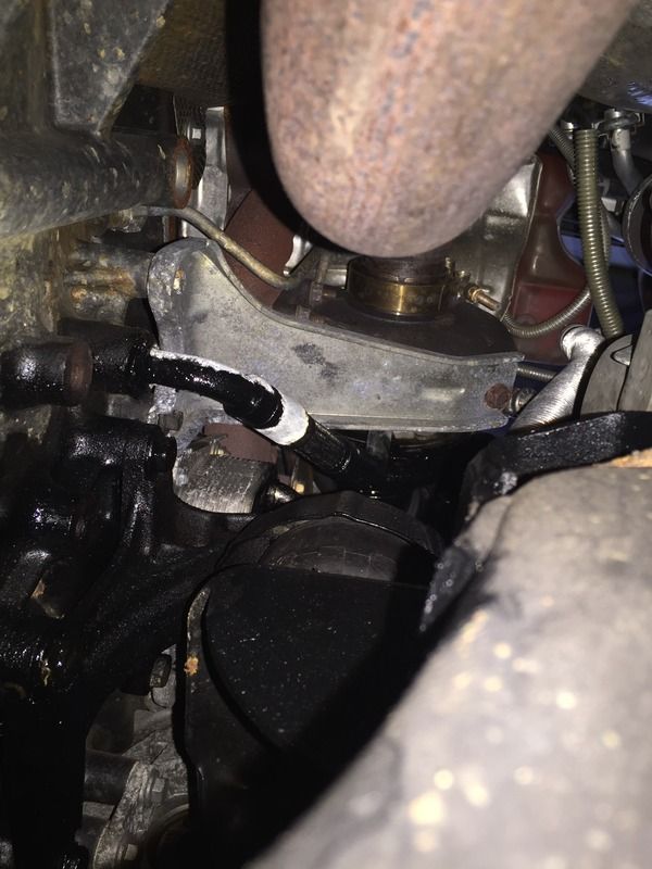

Update, both good and bad.

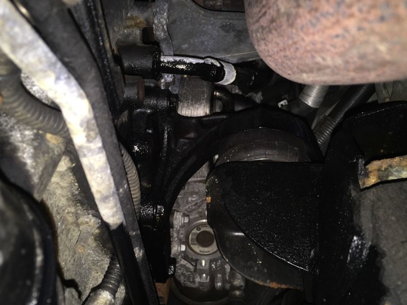

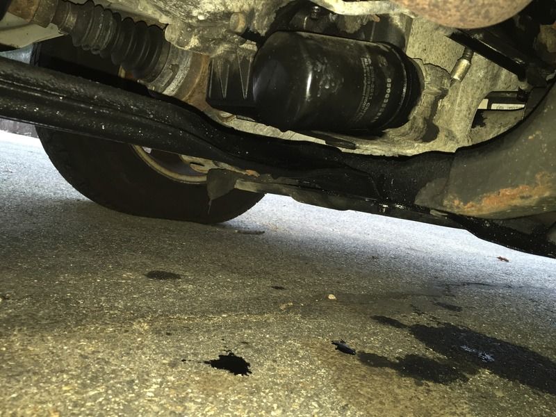

I crawled under the jeep to find that my oil leak that is causing my drive way to have puddles is coming directly from the oil filter. I think the dealership double gasketed the oil filter and I'm calling them tomorrow to make them fix the issue.
I also discovered that one of the lower oil hoses I'm assuming the return line is in fact leaking.

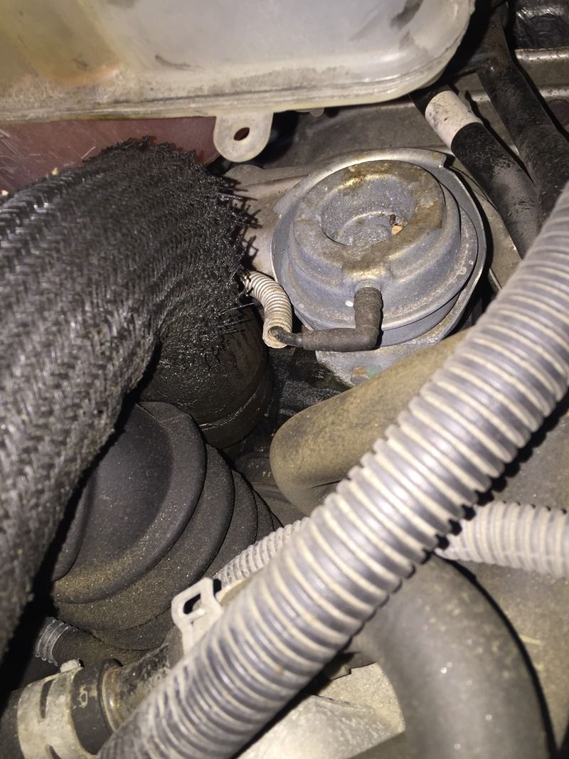

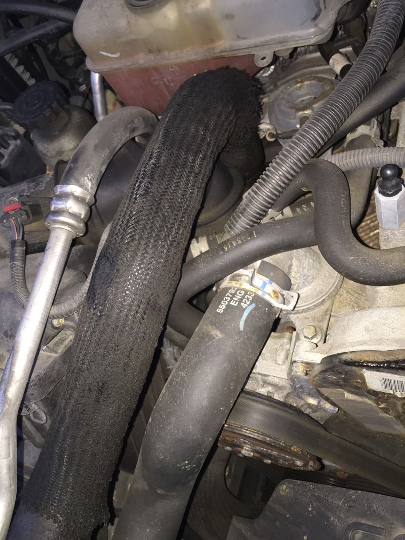

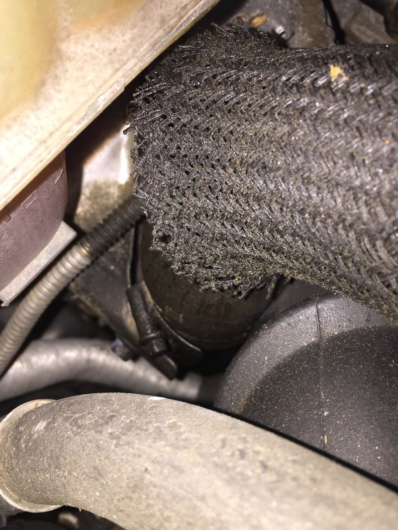

Next I noticed that the large rubber hose that attaches to the top of the turbo is covered in gooey oil and appears to be slightly leaking all over the front portion of the turbo making the turbo look wet with oil.
I took it for a drive since it has been sitting for a while and it can safely go 0-30mph much faster then 30 seconds.
The Bad
While driving it I lightly depressed the brake pedal to wear off the surface rust and when I did this the RPMs went from 2k rpm down to 1k rpm and it felt like it was going to quit. Happens every time I do this? Why?
Other then these issues it seems to be fine.
I'll upload pictures after I upload them to my photobucket.
This part makes me think it's the intake to turbo hose. They are know to rot at the bottom by the turbo and can't tell until you take it off. Plus it sounds like your cac tubes are junk. Time for some samcos or Id parts has their own set for cheaper

It's pretty obvious it's leaking from the oil filter, and they broke a skid plate bolt and crammed a rag in between it and the cross member to stop the rattling!!!
The under side of the turbo near the motor mount
Turbo inlet

I'd change those and then clean the oil up around the turbo oil return line. Then check it again after running it awhile. Typically they seep oil out the rubber plug at the block. There is no pressure so if that is all it is doing I would leave it. They are kinda a pain to change and really unnecessary if it's just weeping out from the block
http://www.idparts.com/turbocharger-oil ... -3208.html
http://www.idparts.com/turbocharger-oil ... -3915.html
