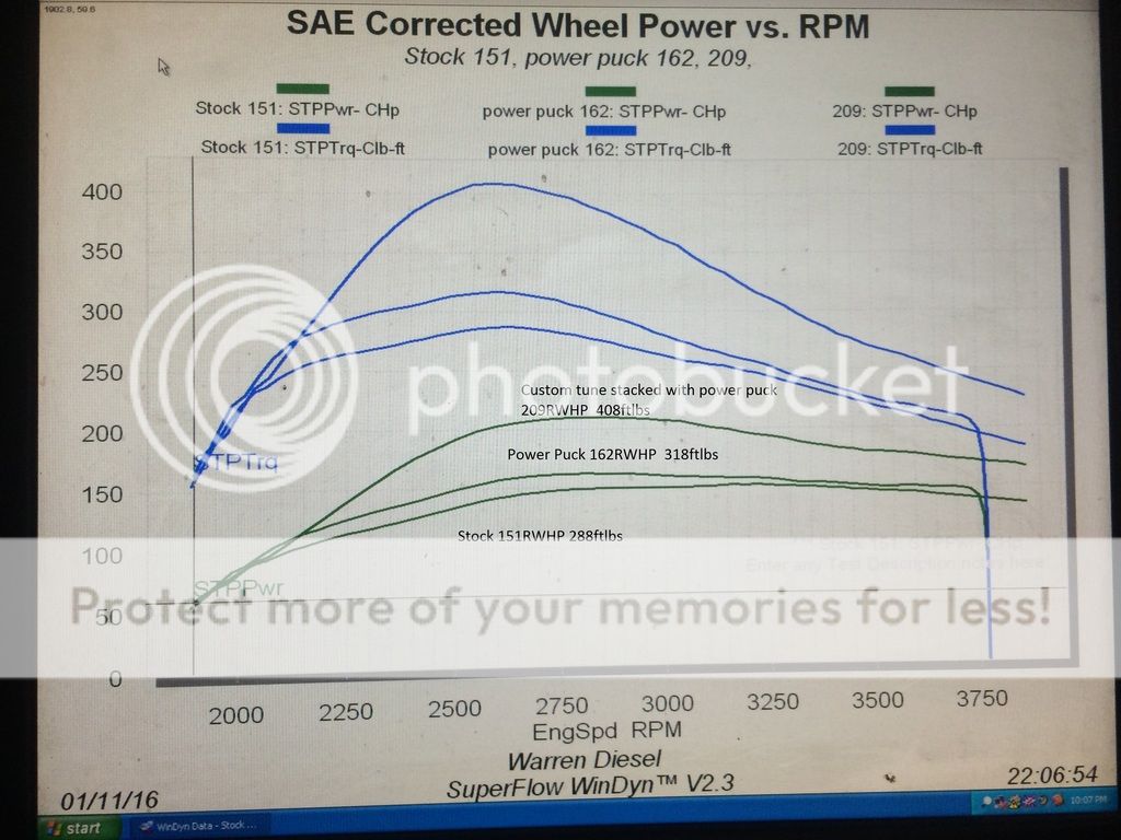

Hi all been browsing here for a while. Lots of good info. This is my 1st post. I am from NW PA own a diesel shop with our own in-house dyno. I tune a lot of Powerstroke diesels been doing it for years, our 06 6.0L race truck makes 1301HP on fuel only so tuning on a diesel is not all new. But tuning a 2.8 CRD is definitely new to me. I got the itch to play with our 05 CRD liberty. :D
I had purchased a 2005 CRD liberty few mo back and lately decided to do some mods. Cat gutted 3" exhaust from cat back. EGR block off not installed yet.
We got a loaded Superflow dyno.

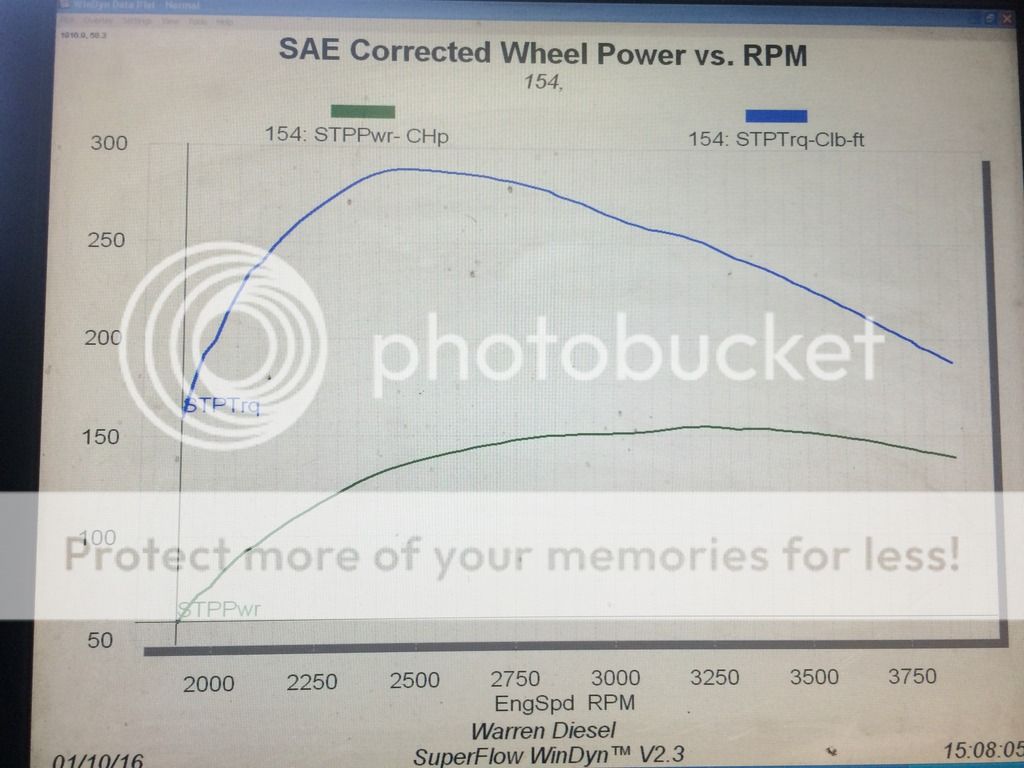

Stock it makes 154HP / 288ftlbs

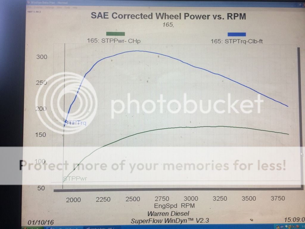

Installed a Power Puck 165HP / 313ftlbs

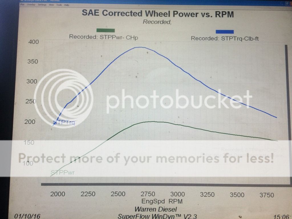

I had ordered MPPS 13.02 along with ECM Titanium. Spend a full day on the dyno tuning. I did not up rail pressure in tuning as the power puck does this. I tuned along with the power puck. I keep torque reduced till 2400RPMs as its still got a stock converter. Shudder was bad if I left it come on hard. Better converter going in this week.
Peak power with our ECM tune and power puck working together. 203RWHP @ 2800RPM 391Ft lbs @ 2600RPM. Backup run was 201RWHP
2005 2.8CRD Liberty
Tuned 211RWHP 412Ft Tq

This dyno is about spot on from all the results we see. Stock 6.0 does close to 250 RWHP. Last week we had a 2005 Chevy Duramax on the dyno it made 260RWHP stock and with the edge on LVL 5 380rwhp. My brother had a 03 mustang single turbo. Makes 705rwhp on a mustang dyno 711 on our dyno. Track times put him at 735rwhp 9.2@149MPH.
Most the guys that run on our dyno say its low :ROTFL:

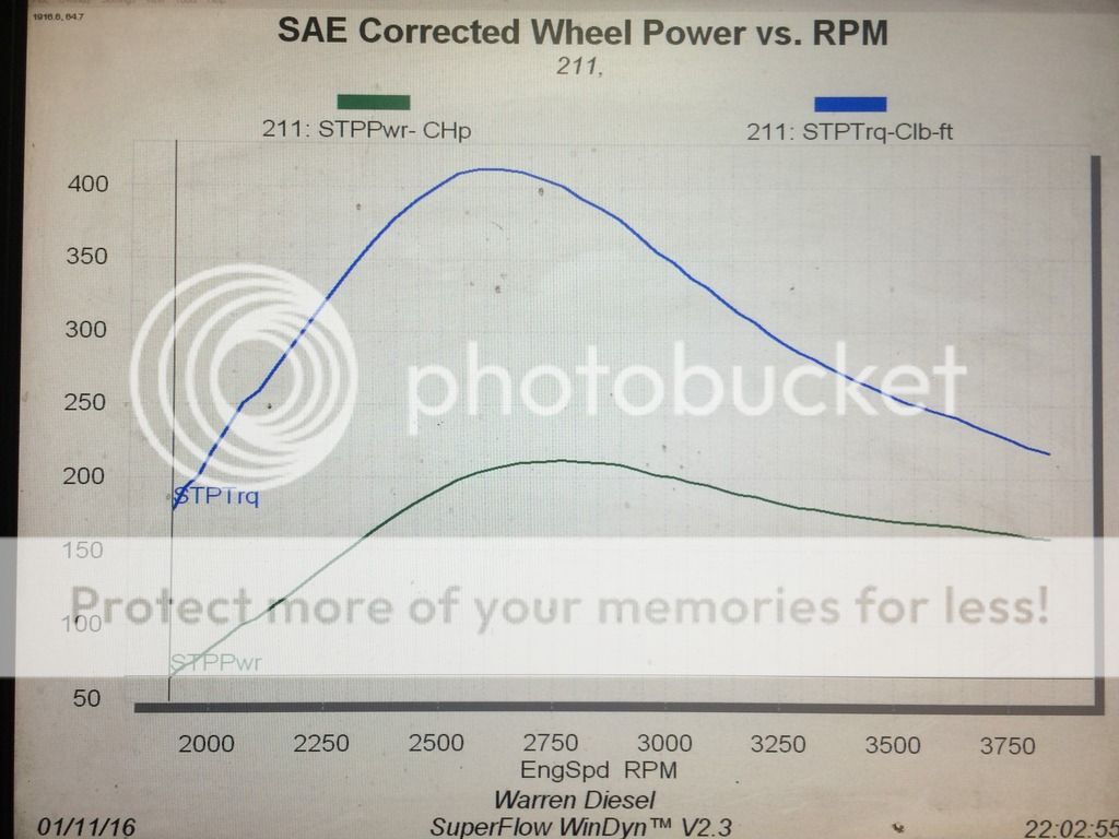

Update: I ordered ARP studs, 5.7 converter and a shift kit.
Had some time this eve so i made some tuning changes and ran some more runs. Different correction factors as its a lot colder tonight. I stated out stock then plugged in the power puck and then flashed the ecm with the latest tune changes.
This tune makes a little more power and hold better top end power. 209HP 408Ft lbs
Backed up with 211HP and 412ftlbs
2005 2.8CRD Liberty
