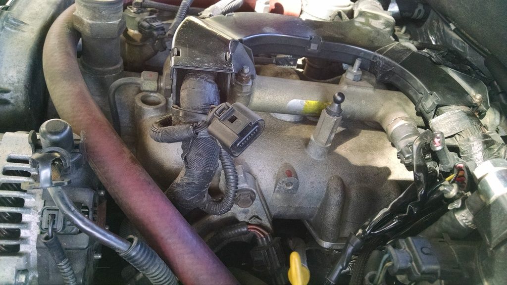

Update:
I don't see any project box under the driver side dash. I couldn't see anything that looked like extra/new/DIY wiring under the hood either, everything looks properly loomed. But there was this one connector just waving in the breeze not connected to anything:
http://i1053.photobucket.com/albums/s46 ... b0ve4m.jpg
When I start it, it jumps to 1200 but only for a split second, then falls down to idle at about 900. As in, when it starts, the tach swings up and immediately back down. It tops out around 1200 but doesn't stay there, if that makes sense.

bootstrapper wrote:
Update:
In that picture, whats disconnected looks like the FCV connector. Its safe to leave that disconnected.
Looks like you might have the Weeks101 intake elbow kit (this would be your EGR delete).
But its really hard to see. Gonna need a better picture of the stuff on the drivers side of the engine.
On left side of that picture I see some non factory wiring harness. Its very well made but not factory.
Looks like its all connected to the MAP sensor.

If he put a tuning box in then it would likely be connected to the fuel rail pressure sensor and the MAP sensor. It just intercepts and alters the signal that the sensors send to the ECU to make the ECU think the fuel pressure and boost pressure is lower than it wants, so it increases them to try and get the signal it desires. So basically the ECU wants to run the fuel at around 23000 psi but with the tuning box the rail pressure may actually 24-25000 psi. Higher pressure means more fuel gets injected and you gain more power.
If you do have a GDE tune then having a tuning box on top of that could be a problem. It could be exceeding the safe limits for boost and rail pressure when the two are in combination.

I to agree from that pic the wire not plugged in is for the fcv. It also looks like you have a weeks kit(egr delete). If no check engine light than you have a tune. I'd call gde and give them your vin and he will be able to confirm.
There are also debates on here wether the elephant hose mod is good for our jeeps. I believe it messes with the needed crankcase pressure and can cause potential harm. Do some searching and make a decision on that. But either put it back to stock or get a provent.
As for the mysterious knob, I'd say start at the knob and try and trace the wires.

You definitely have a Stage 1 intake elbow kit.
Not sure if you have a Stage 2 full EGR delete kit. (Cannot tell for sure without a good photo of the driver's side engine block.)
If your CEL is off and you do not have a tune (as others said, check with Keith@GDE by proving your VIN), then the previous owner disabled it via SEGR or by literally removing the CEL bulb. The CEL should come on momentarily at start up. If it doesn't, you need a new bulb and should look into a GDE tune. If the CEL does come on at startup, you most likely have a tune or a SEGR.
None of this effects shift points.

More driver's side photos:
http://i1053.photobucket.com/albums/s46 ... qanwxs.jpg
http://i1053.photobucket.com/albums/s46 ... ekjbjb.jpg
You guys are amazing. Keep the great advice coming, I can smell an answer...
Except I don't like the answer. Weeks101 was spot-on: the CEL does NOT illuminate at startup. Don't know how I missed that obvious clue before.
I also asked GDE and Matt couldn't find the VIN in their database.
Soooo... Weeks stage 1, probably no tune and probably a fudged CEL. Right? What do you recommend for next step? Weeks 2 is only $65. That wouldn't change the ECU, but would it be a good idea?
