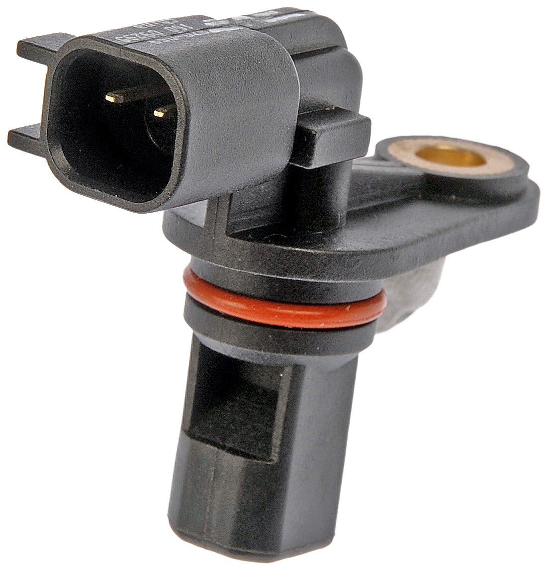

I'm looking to rebuild the harness with new plugs and wire to up under the seat, so I'm looking for 2 new plugs.
I figured these connectors were common enough in automotive applications that I ought to be able to get new for less than $40 for 2.
As a side note I have new sensors but I read 2200 ohms (about right for sensor only), to one rear sensor, and 7000 ohms to the other rear, so despite the fact that circuit has good continuity, I fear I have an internal corrosion issue.

While I appreciate the feedback neither of those are the correct plug for the speed pickups.
This is the connector for the speed sensors, I believe it is EV6.

You're right, sorry, I missed that. I searched on Amazon "ev6 connector" and I got few good priced items, they come with wires.
GooDeal 8pcs EV6 EV14 USCAR Fuel Injector Connector Pigtail Wire for Dodge LS2 LS3 GM Ford https://www.amazon.com/dp/B00YGAJZYC/re ... 2xb0931PYR
Doesn't look exactly like what you need, but I'm pretty sure you can get them on amazon/eBay, especially if you know the type of connector. I also wonder if you can buy a used harness from eBay and get the connectors you need from that.
