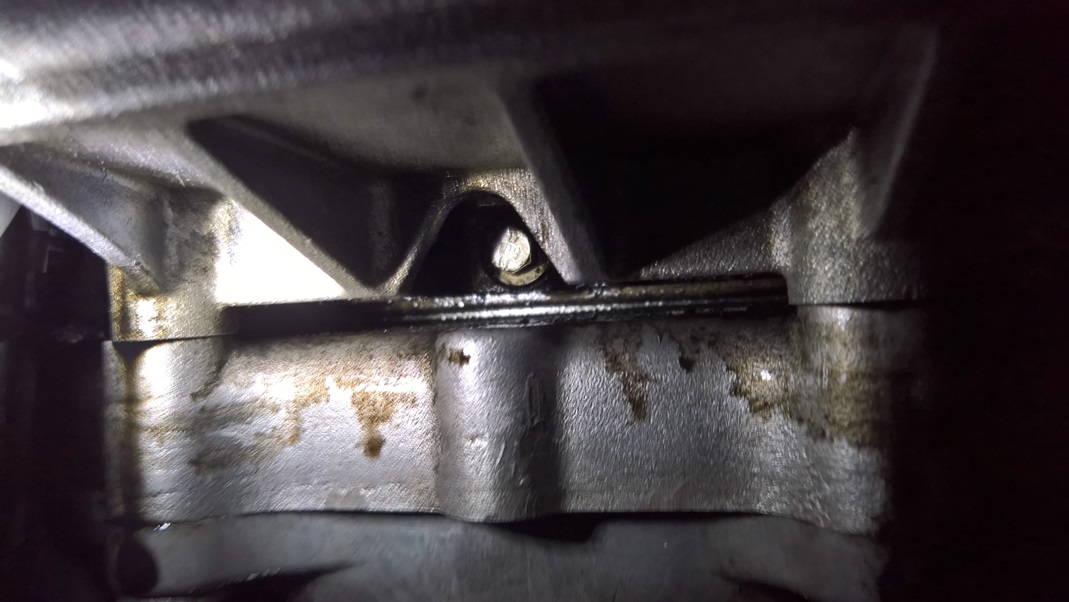

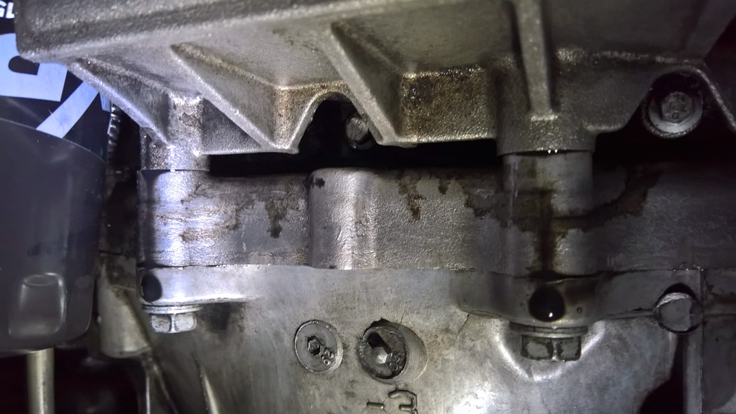

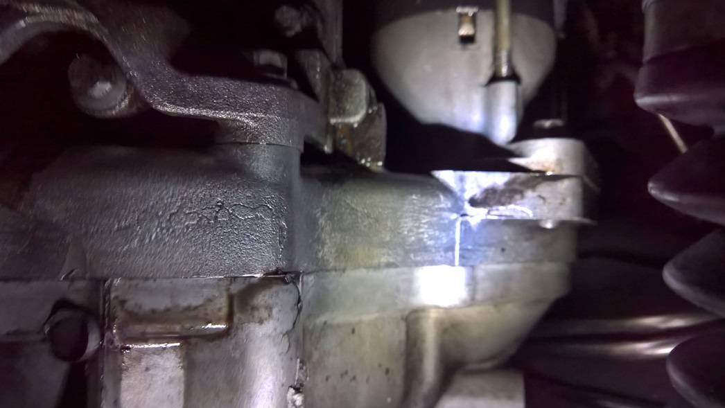

Here's some other stuff:
These photos were taken after a 30 minute drive, sitting about 20 minutes, a full clean, then sitting another 30 minutes. These are streams of oil *long* after shutdown.
There is oil coming down between the engine and the bellhousing "adapter" as well as between the adapter and the transmission. But, there is also oil way up by the starter. All very discouraging.
However, while trying to find the plugs on the back of the head, I referred to this picture I took with the transmission out - I won't put it inline as it's **huge**:
http://sacsaabs.org/sacsaabs.org/misc/0 ... aks2_4.jpg
Note the areas I circled - you can see oil has been flowing through the bolt holes, but there isn't any oil from inside the bellhousing to the outside. Also, these are the SAME spots I'm seeing leaks now. Look over by the starter, and you can see traces of oil from the top to the bottom along the flange.
I think this suggests oil is travelling from above the bellhousing and sort of drilling "through" it. Seems like this supports the idea the leak is above the transmission. But, it also raises the question whether it's coming from the head or maybe even the head gasket. Really not sure how to narrow that down visually.
