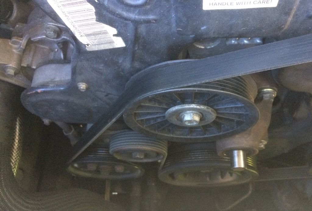

Over the weekend I did my viscous heater delete.
Used gates 38029 pulley and acdelco 6k810 belt.
U.S. Army Retired
Any belt slip on the crank? I'd like to delete it as well. May do the AC at the same time for the winter which will give me some extra wrap on the crank pulley.

No belt slip. Even with the ac on.

Took a quick measurement.
Its roughly 1.75 inches from the VH mounting posts to the inner race of a pulley bearing.
You could start with 1.5 inch OD square steel tube and use some different thickness washers to space the oulley outward
U.S. Army Retired
