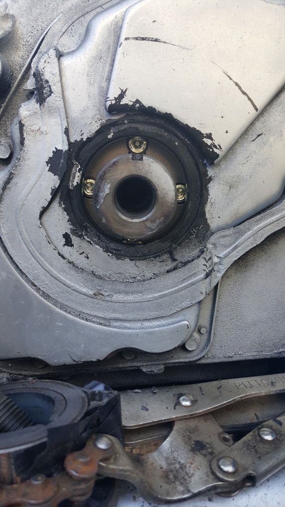

A serious consideration is the distance to the crank's internal bolt-caps from the outer-lip of the block; = 9mm:
The ABI seal I installed is 8.75mm wide. Fortunately, there's about 2mm of room between the block-lip and the inside-edge of the crank sprocket. Pic is side-view of crank pulley (with dangling chain-wrench and chunk of old tbelt for pulley removal&installation):
Solution: leave 1mm +/- of prevail when installing the 8.75mm ABI seal. Actually, I set it slightly further-in after this pic:
