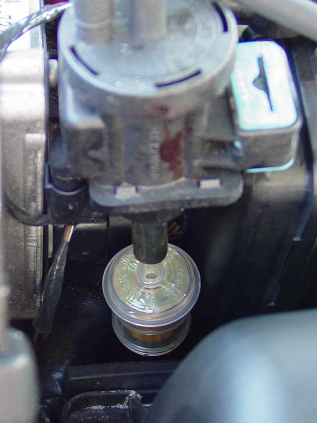

I finally located the boost pressure solenoid filter on the CRD and I felt that other new CRD owners would like to know where it is, since it should be checked every 6000 miles.
It is on the front side of the vacuum tower. This tower is located by the passenger side fender, and is about 3 inches in front of the coolant tank. This filter is about 1 inch behind the air cleaner housing, and about 3 inches away from the passenger side fender. It is a small clear plastic filter, about 1 inch in diameter, and 1 inch long, with a brown paper filter element inside. Apparently, it filters the air used to change the turbocharger pressure, so if it became plugged, it would certainly hurt performance. New ones are about $6 from the dealer.

Mine is still white. I think the filter is for the whole vacuum system and not boost controller alone.

The filter is to let air in reducing vacuum to the turbo, via vacuume regulator, to reduce the amount of boost. If you plug the filter boost will go through the roof. The vacuum system works to remove air and the air filter lets it in which would defeat the purpose.

gsbrockman wrote:
Is this what we're talking about?
Thanks,
Ken Jennings
2006 KJ Limited 4x4 CRD, Option Pkg G, Lt. Khaki, Built 1 Feb 2006
Tow Package for myself, EVIC TPM
Side Curtain Airbags for my daughter
http://www.kenjennings.cc/crd/dieselexp.html
PostPosted: Sun Nov 26, 2006 8:30 am
Posts: 1150
Location: East Tennessee
That is the critter. When I bought my Jeep I noticed it in the maintenance schedule. Asked the salesman, who promptly took me over to service and parts to get an answer. Service was closed and parts was clueless if that is any surprise. :?

Interesting little critter isnt it, hmmmm..... what if you route the little rubber tube to a new fitting to the clean side of the main filter in the top of the air box, you could then forget about ever buying that little filter again. I bet you'd get a couple of other benefits from this as well........ just something to think about and ponder is all ..... :)

When the VGT on the turbo is released from its vacuum prison, the air is sucked through that little filter and is allowed passage into the VGT vacuum supply, which relaxes the vanes and reducing boost because the vacuum is now gone.
The little fellow is also used on euro CRDs but instead of a VGT it supplies vacuum to the EGR valve we use. I just plugged it all up in my own little SEGR mod (as I also did on the TDI) ;)

I'm not too sure that the pressure differential of the air box would be a good thing for proper operation.
