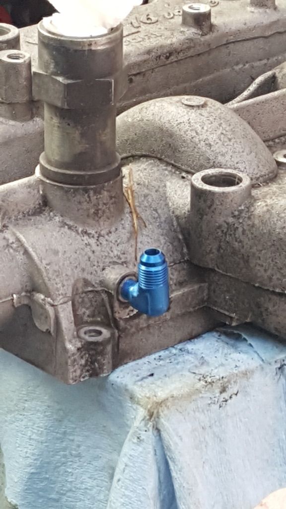

The purpose of tapping the intake manifold is for installing a boost gauge. That plug for the cam pin is not part of the intake path.

Also, I hope you didn't screw that fitting in your cam plug hole with too much force. I would guess those threads are more likely 8mm x 1.25 than any NPT thread. I think it's sealed with a washer which makes no sense if it's pipe thread.

Re blue NPT elbow fitting, it's just snugged finger-tight about three threads, but went in nicely...
So, where's a good location to tap the intake man for boost gauge, particularly to avoid obstructions following complete engine systems reassembly? Presuming a boost gauge would be located in the cabin within driver's view (pillar-mount?), it seems like tapping the intake plenum towards the rear-left would be advantageous. I'll scope some fully-assembled engine pics and evaluate where there's no obstructing system components. Thanks for input!

Not sure if other members have mentioned this but that tapping you show in the photo will not help you with inlet manifold pressure? The only reading will be crankcase pressure/vacuum. Drill and tap into the inlet manifold section of the casing.

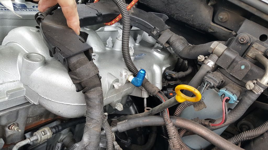

This is a good location to install a fitting for a boost gauge!
Right next to engine dipstick tube. Plenty of metal at this location.
Requires drilling a small like 1/8 hole into the intake and tapping hole to 1/8 pipe threads to install a fitting! :wink:

Awesome, WW; I may also pilfer your surrounding custom "German-Hillbilly" setup of braided-lines und duct-tape :BANANA:
Thanks!
QUESTION- Isn't that a mount-hole for some kinda' bracket?
Did you locate the boost-tap there after some kinda "component delete"??? While I'm a newbie to these and it's been almost four months since I tore this apart, *#@÷!!!, some random memory places a bracket (alternator?) in those two adjacent intake mounting holes, no?

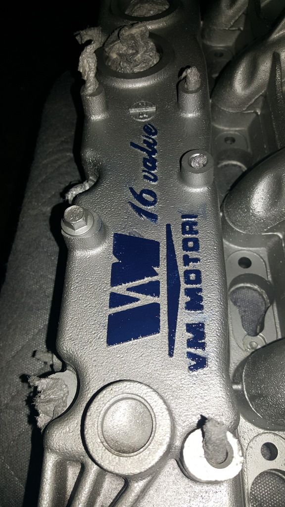

Took my jolly time today.
Proof:
:-)r okay, it's not just me, right? The Italian-made VMotori emblem looks almost identical to the Waste Management logo !
For non-US members, that is an openly mafia-owned US nationwide garbage mega-corporation. Tooo Fn funny !!!
:ROTFL:
BEFORE I tap it up to 1/8" NPT, I'm still hoping someone will confirm that WW's boost-tap location isn't assigned to some stock bracket.
Thanks.
-Update- just scoped a pic on Sam's noob guide; assuming that's a fully-stock engine pictured, WW's tap-location is available and indeed ideal. Dawn's first task.

The upper right thread on the casing is not used in this application, the other 3 are used for the alternator bracket.

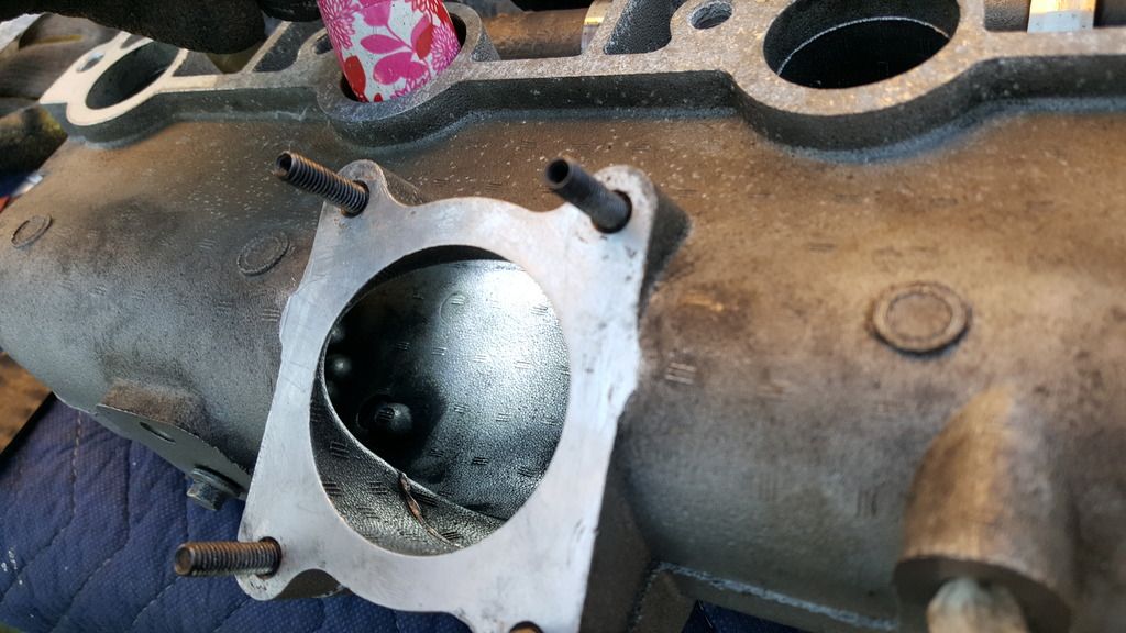

Anticipating a future boost-gauge, I tapped and (temporarily) plugged an eighth-inch NPT hole in the intake man. where Flash recommends; YOU D'MAN!. I was paranoid about possibly cracking the aluminum if I drilled/tapped too small or over-shooting the fit (=too loose) if drilling too large. Hence, I spent three-hours dialing the fit; sorry I didn't write-down the final drill-bit size (those of you saying "Uh, 1/8" bit? can hose-off ).
Bottom line: keep in mind that taps are tapered, so you can bias nominally on the big side. I tapped enough to insert any 1/8" NPT fitting about six-threads deep; given that the hole "tapers tight" that seems sufficient:
The other concern was insuring that any metal filings from the tapping procedure are removed from the intake plenum !!!
I taped-off all the intake-holes except the "main-in" and then used air to blow-through any metal particles. Then, I used a lint-free rag to physically "plow" the plenum clean (+/- 10-passes, all directions). It didn't hurt that previously I'd had the assembly tank-cleaned at the same machine shop that handled the head:
Given the accumulated crud pre-Sasquatch, a satisfying transformation.

Yeah that's not the intake you have your elbow fitted into there. It will, however, do a decent imitation of an oil spouting volcano if you leave it there and crank it up.
But before you get to that point you'll have to remove it to time the cams anyway.
WW's location is a former EGR mount, if I'm not mistaken. probably for the FCV.
If you're installing a stage 1 Weeks kit, there's a bracket that goes somewhere around there that will be used as a top mount for the Vacuum Supply Tube.

Updated pic of tap location in prior post. Replaced pictured -6 AN hose elbow with basic 1/8" NPT plug until boost-gauge happens.
Yeah, I know the paint job is hella' goofy, but it does kinda' help contrast different systems when metal components are 'silvered'. I topped-it with three coats of high-temp clear-coat.
