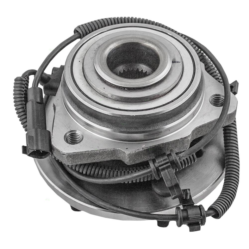

I have a 2005 jeep liberty CRD that has ABS (I doubt they don't have ABS). I know it is a 3 sensor. I am trying to figure out if the forward hub has the speed sensor built into it. If I recall I thought the ABS sensors read the rotation of the wheel from the brake?
TLDR: I need a new front wheel hub assembly. Do I get one with wires or without?

With wires, the sensor is in the hub, not the brake.

Front Wheel Hub
Mopar --
HUB AND BEARING.
Right. Part Number: 52128692AF
Left. Part Number: 52128693AF
Moog and Timken are two of the better aftermarket brands after OEM.
Part Numbers:
moog-513176
moog-513177
2 pc Timken HA599455L

I bought the Timken one for my right front, and it worked fine. Brake sensor line seemed to be the same length as the previous one.
