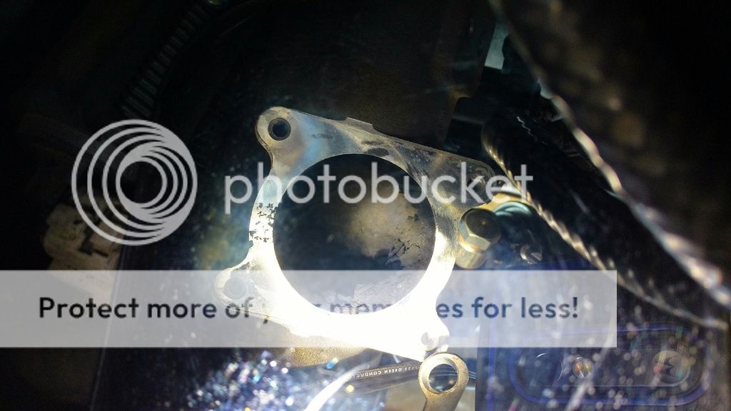

My intake before chiseling out the crud.

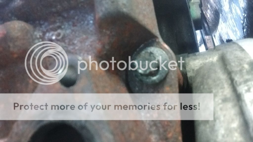

Here's the picture of the stripped bolt head. Do you want a picture of the broken sockets too? :roll:

Heat up the head really good let it cool, then use one of these!!

Tried that. Didn't work. Those sockets don't work unless you can hammer them on for a bite. This bolt is in a ridiculously tight spot. even with an air ratchet and applying as much pressure as possible they would just spin. Someone told me that a gator grip socket would work but at this stage in the game I'm not concerned because the Libby is put back together.

I would grind the head of the bolt off along with however much of the EGR flange it took that got in the way its no good to you now (as if an EGR valve/cooler was ever GOOD to anyone anyway) BTW if you want an undamaged EGR you can have one of mine.
Once you have head of bolt ground off pull egr assembly off of it and decide whether or not u want to wrestle with the rest of the bolt or just leave it there its not hurting anything.

BTW I believe the block is steel but i may be wrong I think I checked when in there and it was magnetic. I am pretty confident that the head is aluminum and I know the valve cover is aluminum.

Can't get a grinder in there. Too tight.

if you don't have torch , there is a mobile welder guy that you can probably find in your area and that can heat up that bolt and remove it ,, but again it will cost you some money , just for that service .so i say get some heat in there ,don't burn the JEEP lol
