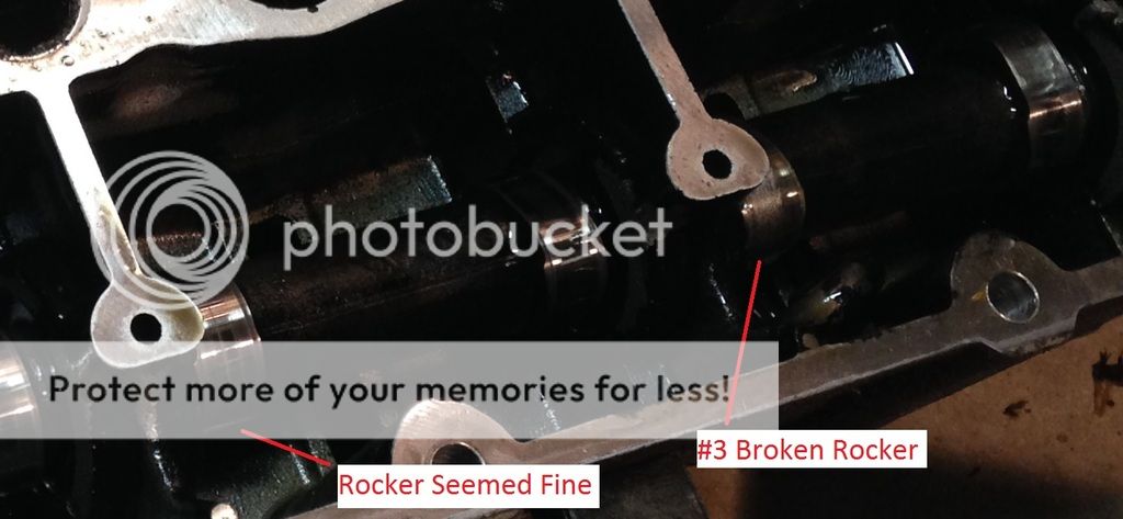

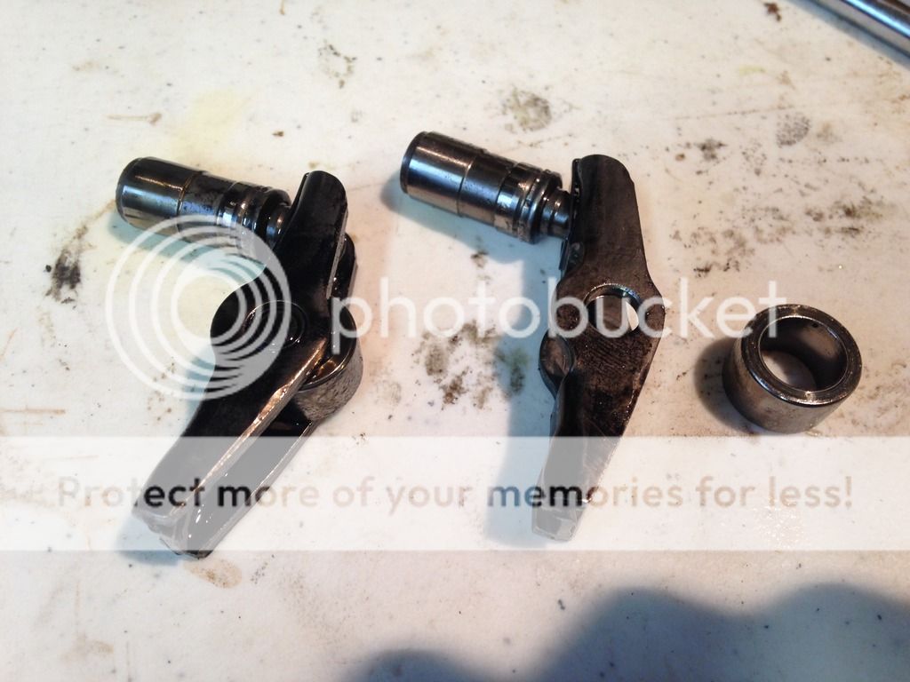

- Two bad rockers, one was missing the roller pin (exhaust #3) and the other was very sloppy with needles moving around (exhaust #4). All of the other rockers (except two tight ones) had some minor play on the roller. A couple of the cam lobes will need to be polished up.

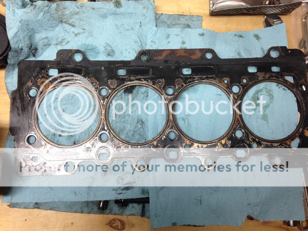

- From looking at the head gasket and top of the block, it appears coolant was seeping into the combustion chamber through the gasket, so I'm hoping new gasket will solve my issue.

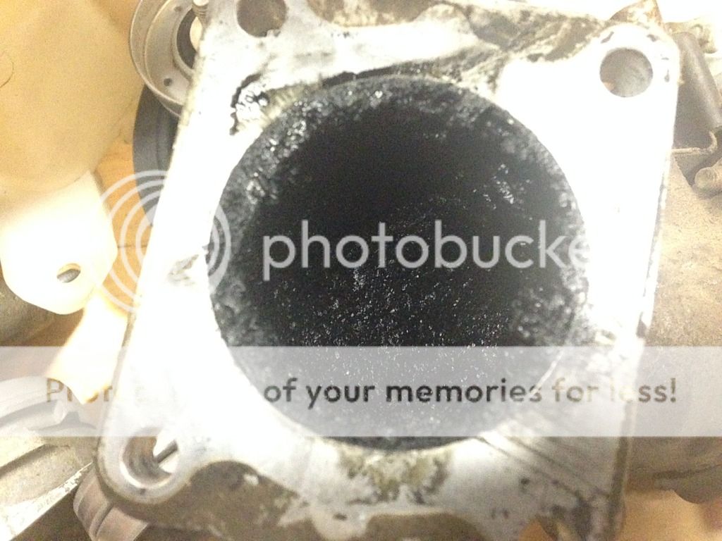

- There was a good coating of sludge on the intake ports and on the FCV, but not as bad as some pics I've seen.
Have a machine shop test the head for cracks.

I hope you will be performing the Weeks delete kits while you've got this thing apart. Between that and the GDE tune my Jeep is like a different animal.
Yes, I believe it would be easier to install the weeks kit than clean this out. FCV inlet was pretty clean though.

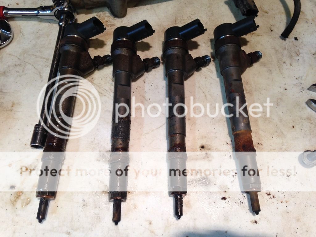

I also dropped my injectors off at the local Midland Diesel shop to be tested, they quoted me $25 per injector. They were very helpful, even did a quick once over on my turbo.

Can you post a picture of the cam lobes?
Will have to get a better pic next time I visit the machine shop, but here is a zoomed in one I took of the valve cover. Machine shop said the cam profile was wore down past the point where they'd grind it smooth, but the profile looked fine to me just had some nasty surface damage all the way around. Strange how the surface damage is pretty much in the middle of the lobe, not on the edges where the rocker arms would contact once the roller was gone, unless something got in there before/after the roller dropped out. Or this rocker didn't get proper lubrication which caused the failure?
Can I keep running with this cam, weather or not I clean up the lobe surface?

camshafts are surface hardened. The lobe with the broken rocker looks bad and I would say needs if possible reground and surface hardened to prevent premature wear.
It seems that the roller bearing froze up which then lead to the wear on the cam lobe.
What oil were you using?
I would not reuse that camshaft. Grinding it smooth may change the lobe profile, which might change valve lash, which might lead to another rocker failure.
It not like the old SB Chevy where you could regrind the cam and install longer pushrods or adjust valve lash.

If the rough area on the camshaft cannot be polished back to a very smooth surface matching the other lobes, it should not be reused! If you reuse it with a rough lobe, it will cause the roller on the new rocker to eventually fail... :roll:
If it were mine, and it could not be polished out, I definitely would replace the cam!!!!
You do not want to have to go back into the top end of the engine in the near future if it can be prevented... :wink:

Pressure test results came back, leaky head. Somewhere between one of the intake feeds and the valve seat. Not looking forward to buying a new/reman head but might be a blessing in disguise.
I also got my injectors back, they ran fine for the most part, 3 out of the 4 had a little higher output at idle flow. When they cleaned up my injectors they also took off the markings I had on which cylinder they came out of, do they need to go back into the same position?
