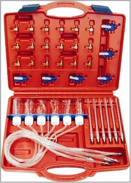

You can do a injector return flow test.
Whichever injector is returning the least fuel is bad.
I used a test kit like this one. Available from ebay or amazon.
