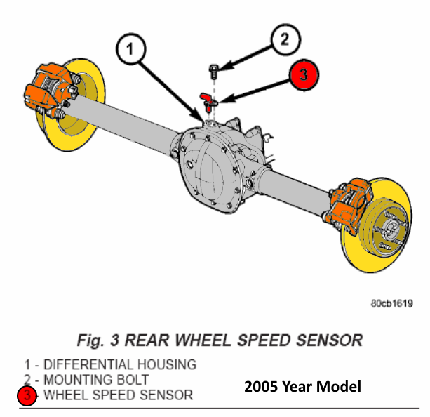

there is no "controller" under the rear seat. The signal from wheel speed sensor on top of the rear differential is also used for the odometer. The ABS controller is in the engine bay under the brake power boost. There is a "connector" under the rear seat and the wiring between this connector at the differential mounted wheel speed sensor is notorious for failing. Check the wiring for continuity and most likely you will find the problem.
"Frying" your brakes should not have generated an ABS fault light. I think that is just coincidence that they happen at the same time.
I am going through the same ABS light/odometer problem, and after three sensors, a new wheel speed sensor connector, and redoing (soldering previously compression splices) four set of splices in the wiring I have yet to solve the issue. My next step is to remove the left side rear seat and check the wiring for continuity inside the car between the floor seal plug and the connector. Otherwise I will be looking for crud in the tone wheel inside the differential housing.

On the 2005 the sensor on top of the diff is also used for ABS and usually for the speedometer...not sure about the 2005!

Edit: The FSM shows two rear wheel speed sensors, maybe that's on a 2006. WRONG, mine only has the diffy and no wires going to rear wheels. At least the driver side rear where I was crawled under.

The 05 models indeed does only have ONE rear speed sensor on top of the rear differential and several LOST members have reported of finding a broken wire at the connector.
The odometer is triggered by the rear differential speed sensor.
Repair kits are available for the wire connector at:> http://connectors.dcctools.com/home.htm ... 09DCEC03D2
or Google: Full Repair Kit: 05013995AA :google:
06 models have a whole different ABS system and they have a speed sensor at EACH wheel.

Wow, thanks for info! In my case wiring was OK and was just the sensor. All cleared once I installed new Oreily sensor and the temp seems to be working right now. Crazy how that's RELATED.

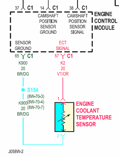

Looking at the wiring diagrams, the coolant temperature has NO common connections between it and the ABS parts.
The coolant temperature sensor is hard wired directly to the ECM and does not go through the Front Control Module.
I would check the wiring and connector closely for any problems.
Your issue may have strictly been coincidental.

Not coolant! Outside air ambient temp. Others on this forum have also mentioned correlation. Crazy
