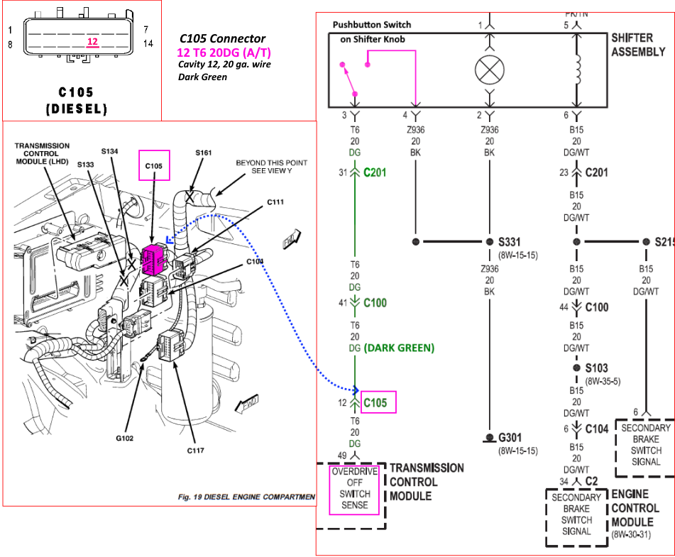

Locate the DG (20 ga. Dark Green) wire that goes into the C105 connector @ position 12 that is located near the TCM (Transmission Control Module). See enhanced drawings below:
Cut this wire and connect cut ends to a simple on/off toggle switch and mount the switch in a safe location under the hood.
Be sure and seal all connections real good with heat shrink wrap tubing or liquid tape.
This would allow you to disable the Overdrive lockout switch/circuit with the simple flip of a switch under the hood at your discretion and you could put it back in service anytime you wanted to.
