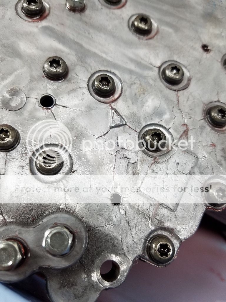

Is this cracked valve body plate normal?

I’ve never seen that before.
Are they actual cracks or just a very rough aluminum casting?

Not exactly sure. They looked like casting defects, but on that raised rectangle that you can see in the picture, I ground down the protrusions, and they still appeared to be present. I just changed the solenoid pack, and the pressure transducer because I have been throwing P0706. The car has no power and seems to be in a limp mode, but the transmission is shifting. After changing the solenoid pack and clearing the codes, P0706 came back. I also had code U0002 which is some communication issue with the ESP. I have the transmission speed input and output sensors. I don't think that's it, but they are easy enough to change.
I noticed the same “cracking” on the valve body plate. In my case the cracks are limited to the area directly above the sump filter.
